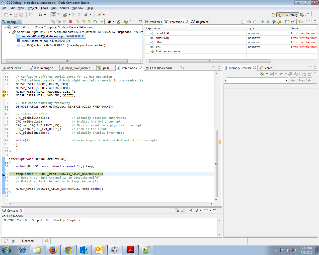

When I debug the project, the program doesnt jump into the serialPortRcvISR.
What did I forget?

  • I'm able to get into ISR routine.
    Just I imported the code from the link  you given and changed the location of LIBRARY and INCLUDE file.
    Configured the on the board emulator and got working. Thats it.

    when i debug the project, the program jumps only once into the ISR.
    Did I something wrong with the library?

  • Hi Chris,
    Nothing I changed as I told before, simply I imported and given correct library and include path then I did rebuild, after that I got working.
