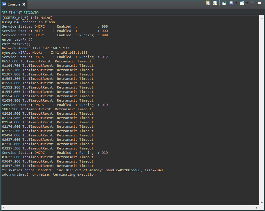

After some time (one hour) gives me the following error:
It seems to be overflow memory, but because reason this occurs?
How can I solve the problem?

Update:
It seems that there is an internal error in the function IDLE, which causes memory not be released by "dchild".
How do I know what causes this internal error?

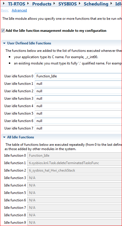

    I have in app.cfg:
    Task.deleteTerminatedTasks = true;
    I have a task IDLE, but it is not clear tasks (dchilds).
    Is there a command for this?

    and it seems has improved. For now there again block.
    But still continues to appear "TcpTimeoutRexmt: Retransmit Timeout" after a "Service Status: dhcpc: Enabled: Running: 019". Reason why?
    Aquino

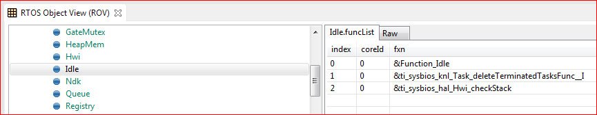

    The Idle task gets plugged with the clean-up function automatically if Task.deleteTerminatedTasks = true. If you open Idle in ROV, you should see Task_deleteTerminatedTasksFunc in the list.
    Todd
  • Hi Todd,
    Yes increasing the Global.pktNumFrameBufs (eg 16) without faster memory.
    In ROV IDLE can see    ->   ti_sysbios_knl_Task_deleteTerminatedTasksFunc_I,
    in app.cfg have   -> Task.deleteTerminatedTasks = true;
    But for some reason unknown to dchold continues to fill the memory.
    The "Retransmit Timeout" is normal?
    The problem I have is that "dchild" does not release memory at certain times. Is there any solution?
    SEE ON TOP IMAGE UPDATED
    Aquino
  • Did you plug anything into the Idle Task in the .cfg file? If you did, does it call a blocking API (e.g. Semaphore_pend). You can look at  the idle functions in ROV to see what is there. As I noted earlier, "Task_deleteTerminatedTasksFunc" should be there.
    "Internal Error" in the Task view in ROV occurs when there is a problem with the item that the task is pending on. The Idle task should never pend on something.
    Can you put a breakpoint at "ti_sysbios_knl_Idle_run__E"? This is the loop that executes the idle functions. Of course, this will never be hit if you are CPU bound and idle never gets a chance to run.
    Todd
  • Hi Todd
    The "Task_deleteTerminatedTasksFunc" ROV is in IDLE.
    See the image above.
    Ie it exists, which makes pending task? I do not understand the task to be pending.
    I have put an breakpoint at "ti_sysbios_knl_Idle_run__E" in Idle.h but never gets hit!
    I'm not understand!
    Aquino
  • Aquino,
    What is Function_Idle() doing? It must run to completion without blocking (e.g. call Semaphore_pend or write out a driver that blocks on a semaphore). It should not be polling either.
    Todd
  • Hi Todd,
    This function was created by me and is only doing this:
    void Function_Idle (void)
    i16IdleCount += 1;
    Log_info1("Idle TOGGLED [%u] times", i16IdleCount);
    Already deleted this function also, however I still have the same problem!
    Aquino
