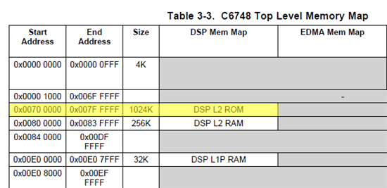

    One caveat so far.  I haven't been able get it to load the interrupt vector table into the default location in memory (the default location specified in the ISTP control register (which is 0x00700000).  Instead, it allows me to load the interrupt vector table somewhere else in memory and then I must load the ISTP register with a pointer to that location. Why is that?
    What must I do to load the interrupt vector table where the processor already expects it to be located?
    First thing to check -- what is 0x00700000?
    As you can see that address corresponds to read only memory.  That's why you cannot put your table there, i.e. you cannot write to that address!  The L2 ROM is where we keep our bootloader.  When the device comes out of reset we always want our bootloader to execute.  If a reset occurred at run-time then the ISTP register would go back to its default value of 0x00700000 and the CPU would execute from the L2 ROM just like at power-up.

  • Brad,
    THANK YOU!!!  You're super clear and super helpful.
    FYI, I'll show something that was confusing me.  From the C674x Instruction Set manual:
    "After reset, you can relocate the IST by writing a new value to ISTB. If relocated, the first ISFP (corresponding to RESET) is never executed via interrupt processing, because reset clears the ISTB to its default value."  [page 46 -- Table 2-15. Interrupt Service Table Pointer Register (ISTP) Field Descriptions]
    The manual indicates "you can relocate the Interrupt Service Table".  When the fact is you MUST relocate it, if you want to set interrupt vectors different from the default.  [This is because (as you showed), on powerup, the ISTB points to an Interrupt Service Table in ROM, which cannot be changed.]
  • I see what you mean.  To give you a little other insight, this register has been part of the c6000 architecture going all the way back to the 62x devices 10 years ago (or more!).  I had an old CPU Reference Guide from 2003 that has the following paragraph:
    "After reset, you can relocate the IST by writing a new value to ISTB.  If relocated, the first ISFP (corresponding to RESET) is never executed via interrupt processing, because reset sets the ISTB to 0."
    Sound familiar?!  :)  Back then it used to default to a value of 0 which happened to correspond to RAM.  That was back before ROM bootloaders existed (or at least before they were typical) and so at that time it was actually possible to put your vector table at that address and never change ISTP.
    One more thing to keep in mind is that the 674x Instruction Set manual is generic to the core, so depending on how we did our device integration you may or may not need to change that register.  In other words, it might not always be necessary to change it depending on the device we make.
