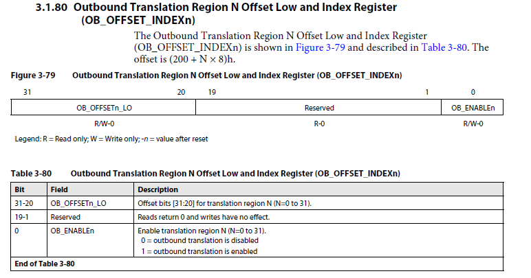

I have a question about the address translation of the following request:
Transmitting an 8MB buffer located at 0x80000000-0x80800000 to to a PC with PCIe address = 0x8CB22000.
As I understand from the example PCIe Outbound Address Translation in PCIe UseCases for Keystone Devices:
CMD_STATUS[OB_XLT_EN] = 1
OB_SIZE = 8MB
Transfer to PCI_Data:  dataSize = 8MB, srcAddr = 0x80000000, dstAddr = 0x60000000
OB_OFFSET_INDEX0 = 0x8CB22001 ( PCIe address with enabling the region)
OB_OFFSET0_Hi = 0x0
According to the example the translated address will be:
bits[31:23] of 0x8CB22000 + bits[22:0] of 0x60000000 = 0x8C800000 (bits 22:0 are zeroed)
To get the correct PCIe address I need to split the PCI address between the 2 elements as follows:
Transfer to PCI_Data:  dataSize = 8MB, srcAddr = 0x80000000, dstAddr = 0x60522000
OB_OFFSET_INDEX0 = 0x8CB22001 (Outbound PCIe address with enabling region 0)
OB_OFFSET0_Hi = 0x0
OB_OFFSET_INDEX1 = 0x8CE00001 (Remaining of buffer and enabling region 1)
OB_OFFSET1_Hi = 0x0
bits[31:23] of 0x8CB22000 + bits[22:0] of 0x60522000  = 0x8CB22000
This will cause the 8MB buffer to be transfered via 2 regions; region0 and region1.
It seems wrong to me.
What is the right way to do it?
Alan.

  • Hi Ganapathi,
    Thank you for the prompt answer.
    As I wrote in my post, I already read the sprabk8.pdf.
    In the example the PCIe address is 0x70000000 that doesn't have a problem with taking out only its 9 MSB.
    ( BTW, I have a problem understanding how can it be chosen randomly, and if it is so why choosing it at all,
    set it as a constant)
    The question is what about a PCIe address that is given (0x8CB22000) and can't be chosen,
    what about bits 22:0, how are they going to be treated?
    Alan.

    I think that my question is not clear enough so I'll try to rephrase it.
    I want to transmit an 8MB buffer located at 0x80000000-0x80800000 to an internal buffer in a PC with a given PCIe address = 0x8CB22000.
    As I understand from the example in the PCIe UC:
    OB_SIZE = 8MB
    I would like  to use region 0, so I transmit the data  to PCI_DATA address 0x60000000  (bits [23:27] = 0)
    OB_OFFSET0_Hi = 0x0
    Are the above settings correct ? If not, what should be the right setting?
    bits[31:23] of 0x8CB22000 + bits[22:0] of 0x60000000 = 0x8C800000 (bits 22:0 are zeroed).
    Am I right? If not, what is the translated address?
    I understand that the translated address should be equal to the destination given PCI address 0x8CB22000, am I right?
    Thanks again,
    Ilan.
    As per PCIe user guide OB_OFFSET_INDEX register OB_OFFSETn_LO write access bit filed(31-20) and OB_ENABLEn bit field(0), other bit fields are reserved. User can able to choose the PCIe address based on the OB_OFFSETn_LO bit filed(31-20). If you write 0x8CB22000 address means the reserved bit field are not updated on OB_OFFSETn_LO register.
