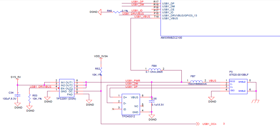

    I have an issue with usb devices such as mouse or touchscreen monitor. Sometimes the device stop working and the only way to resume it is to restart the system. The problem is probably related to an interference in the usb cable from the host to the device. I can see usb signals using an oscilloscope and the interference cause the 5V line to drop down until 4V but this occur in 3-4mSec after that the signal goes to 5V again. Often the device continues to work even with interferences, but sometimes the 5V line goes to 0V and the device can't work until a reboot. I read the register 0x47401818 which is USB1STAT and it give the current DRVVBUS value, the value is 1 when the device work correctly and the 5V line is high but it is 0 when the 5V line goes to 0V. Is there a way to activate the line again automatically or by a command in order to make the device operating without restart the system?
    I have the kernel 3.8.13-bone30 and Ubuntu saucy as OS. I tried the commands posted above but it doesn't make effect.

  • AM335x doesn't have a dedicated USB OC pin so USBn_VBUS is used to monitor the state of VBUS. If VBUS droops below ~4.4V while in session the controller will assume the power switch is in OC and will exit the session and de-assert DRVVBUS (if in Host mode).
    What kind of interference is causing a 1V drop in VBUS? Can you describe your cable? Do you have the required >=120uF of capacitance on VBUS?

    The capacitance is present on the VBUS, I'm using a usb mouse connected via its own cable. In the case of the touch monitor it is connected with an Hi-Speed usb cable type A-B. I'm searching for the voltage drop cause.
    Is there a way to soft resume the usb session without restarting the AM335x? I can monitor the USB1STAT that give the DRVVBUS status and in the case it is low I can run a procedure to resume the usb session.
  • Excuse me,
    I checked the schematic of the PCB between AM335x and the USB connector, the capacitor I have is only 100uF and it is placed before the power switch. Is it correct in that place? I attached the part of the schematic.
  • I'm not an expert on the power switches, but based on a cursory review of the data manual I don't see this as being a big problem. I'd always prefer that bulk capacitance be placed as close to the sink (the USB socket in this case) as possible though. Any chance you could replace C35 with =>120uF and retest?
    Also, FB8 and FB7 shouldn't typically be needed.
  • I'll try to replace C35 and I can mount a capacitor on VBUS near the USB socket in order to check if the issue persist. This will take a while for me.
