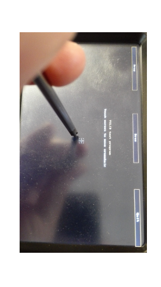

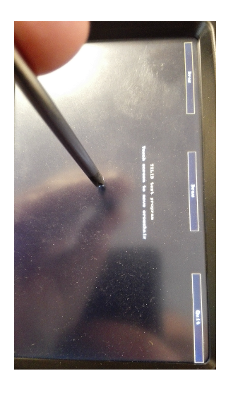

When I use several time ts_test from tslib, my mouse pointer is not at same position between to ts_test execution.
I launch ts_test :
my mouse position is at a position (image1.png)
I close ts_test.
I launch again ts_test
my mouse position is at another position (image2.png)
sometime mouse position are same position, sometime not.
If I don't stop ts_test execution, mouse position offset compared to touch position is always the same whatever the touch position.
