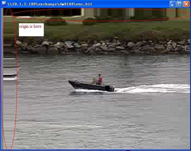

i'm using dvrrdk4.0 to do h264 transcode, transcode is done by dec link+enc link, the origin of decoded picture in buffer is not (0,0), but the encoder treats the picture's origin as (0,0), so the expanded edge by decoder is encoded, how to fix it ? thaks!

    the encoded width and height is correct, but the origin is not correct. the transcode chain is bitoutHLOS->bitinRTOS->Dec->Enc->bitoutRTOS->bitinHLOS, there is no capture, i don't know how to notify enc link the origin of video frame, because the origin of video frame from dec link is not (0,0).

  • Hi,Gajanan
    as you said, the origin of 352x288 in 384x320, maybe [0,0],[16,16],[32,32],...,which parameter stands for the origin?
  • Hi Huang Jack,
    The below are the example parameters to use to get the behaviour of origin as you said -
    captureWidth   = 384     # Image capture width
    captureHeight = 320    # Image capture height
    inputWidth       = 352    # width of image
    inputHeight     = 288    # Height of image
                Codec internally calculate the difference (i.e Width (384 - 352), Height (320 - 288)). So the origin of the frame will be (32x32) which no need to specify and codec will take of this.
    Gajanan
