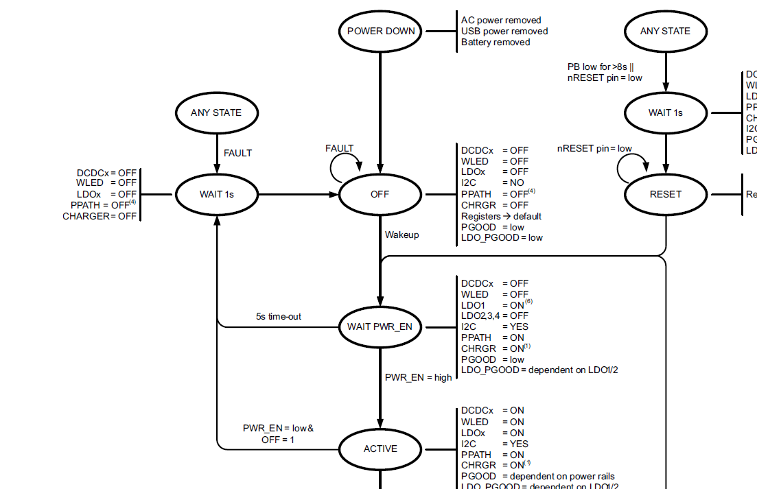

The datasheet of TPS65217 details the functionality of PB_IN pin of the TPS65217 as below :
  • Power-up the device from OFF or SLEEP mode upon detecting a falling edge on PB_IN.
  • Power cycle the device when PB_IN is held low for > 8 s.
We assume that the power cycle refers to the PMIC starting a new power - up sequence. This will result in rebooting of the system.
We tried this using Beagle bone black (by pressing Switch S1 for 8 secs) & the board powered off rather than rebooting.
Can somebody please clarify the functionality of PB_IN pin of TPS65217 ? Is the functionality is power cycle or power off ?

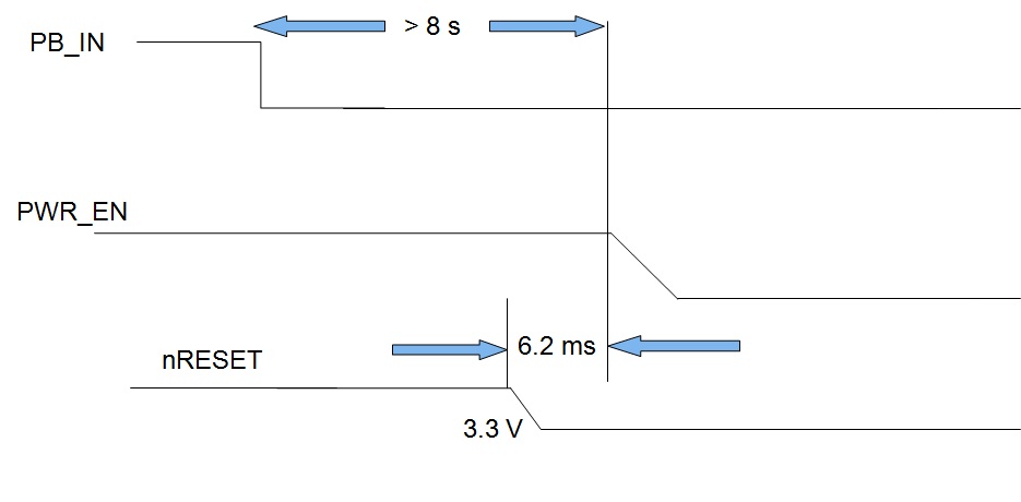

  • Suresha,
    It would be helpful to provide scope shots of the following during your test:
    1. PB_IN
    2. nRESET
    3. PWR_EN
    In the wait power enable state the only resource that should be on is LDO1. All other rails are off, while waiting for a wakeup event during the 5s.
    Janice
  • Janice,
    Please find the snapshot of the signals below :
    After 8 secs of PB_IN press, nRESET will remain at 3.3V & PWR_EN at 0V.  These signals will return to earlier state after next falling edge of PB_IN.

  • The 6.2ms between reset assertion (start of powerdown sequencer) and PWR_EN going low is also strange. Based on documentation, the only reasons for PWR_EN going low would be a scheduled shutdown (rtc alarm2), or the vrtc supply (LDO1) being cut. However, during a normal sequenced shutdown there should be 11ms between reset assertion (PGOOD low) and LDO1 shutdown.
    Two possibilities that come to mind:
    1. The RTC for some reason decides to drive PWR_EN low, and this perhaps preempts the reset-sequence and causes the PMIC to enter OFF-state instead. I see no reason why the RTC would do this (a scheduled shutdown makes no sense here) nor would I expect the PMIC to care about PWR_EN while performing a reset, but who knows.
    2. A fault occurs during the shutdown sequence, causing LDO1 to be cut prematurely (hence PWR_EN goes low) and OFF-state to be entered.

    Looking at the the TPS65217 state diagram, it looks that power cycle is the expected behavior when PB_IN is pressed for more than 8secs.
    In case of  poweroff condition observed in BBB, PMIC might be entering the fault condition due to which power cycle is not happening.

    As long as PWR_EN is pulled high once the device exits RESET state board will reboot and enter ACTIVE state, not power down and go to OFF state. If PWR_EN is pulled low once out of RESET state the device will wait 1s and move to OFF state. If you think that the power sequence isn't being followed properly, try this clamp circuit to ensure the proper power down is being followed.
    Let me know if this helps.
