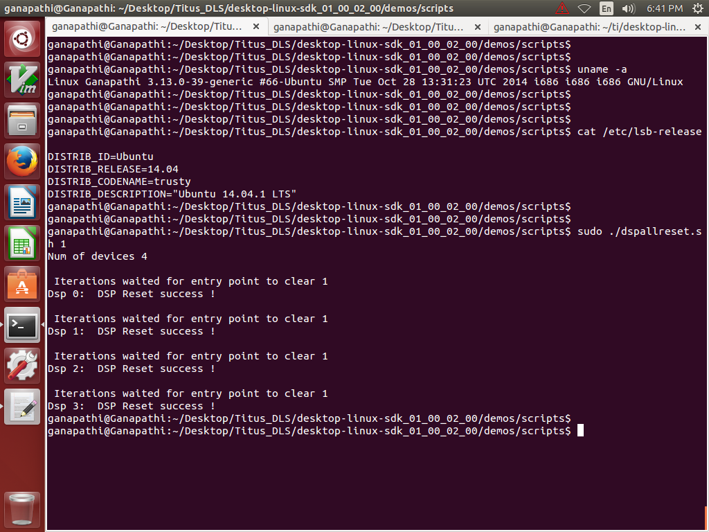

  • I have tested the reset command in Ubuntu 14.04. It is working fine.

  • Hi Andrey,
    I have tested the reset functionality for DSPC8681E board on Ubuntu linux 14.04 host machine.
  • Can you guys test on 64-bit Ubuntu 14.04 release?  Titus's Ubuntu 14.04 is the 32-bit version.
    I am seeing the same failures on my 64-bit Ubuntu 14.04:
