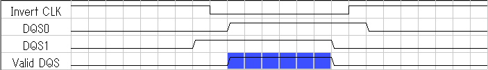

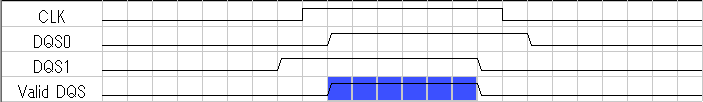

We have a board where the lengths are DDR_DQS0 > DDR_CLK, but DDR_DSQ0 < DDR_CLK (only by a couple of mils):
DDR_CLK = 0.903"
DDR_DQS0 = 0.980"
DDR_DQS1 = 0.901"
Is it correct to use:
PHY_INVERT_CLKOUT = 1
In this situation, and is the AM3359 DDR controller able to work with these lengths?
