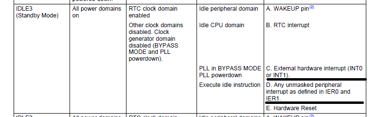

Hi community member,
Please let me confirm the following question.
[Question]
 Can C5535  wake up from IDLE3 mode by IER0 and IER1?
Best regards.
Kaka
