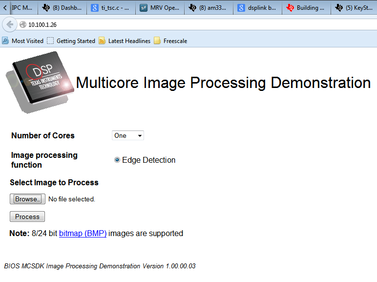

    9. You will get the console messages with one IP address like below.
    10. open up the browser and type the ip address.... You will get it now.

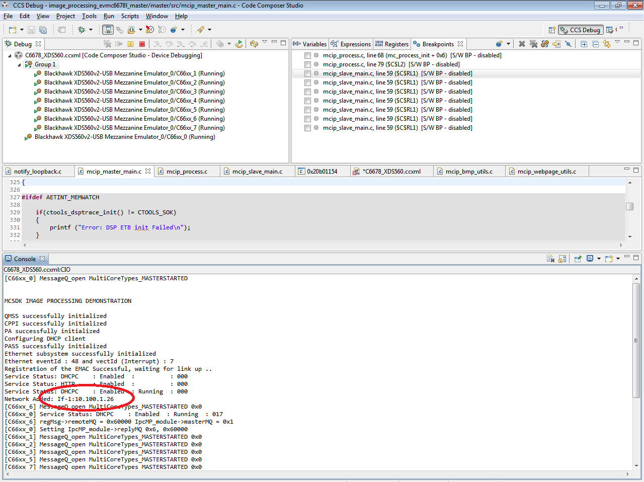

  • Thank you Rajasekaran and Shankari
    My previous problem solved. Know i see IP=192.168.2.100 in console window as a static IP. Do you know how can i use dynamic IP instead of static IP?
  • Hi Armin,
    It is decided by boot mode switch settings,
    5. Set User Switch for the demo application
    The application needs an IP address. It can use either a static IP address (pre-configured) or it can request one using DHCP. This is controlled by setting dip switch 2 of SW9.
    User Switch 2 ON : DHCP
    User Switch 2 OFF: Static IP
