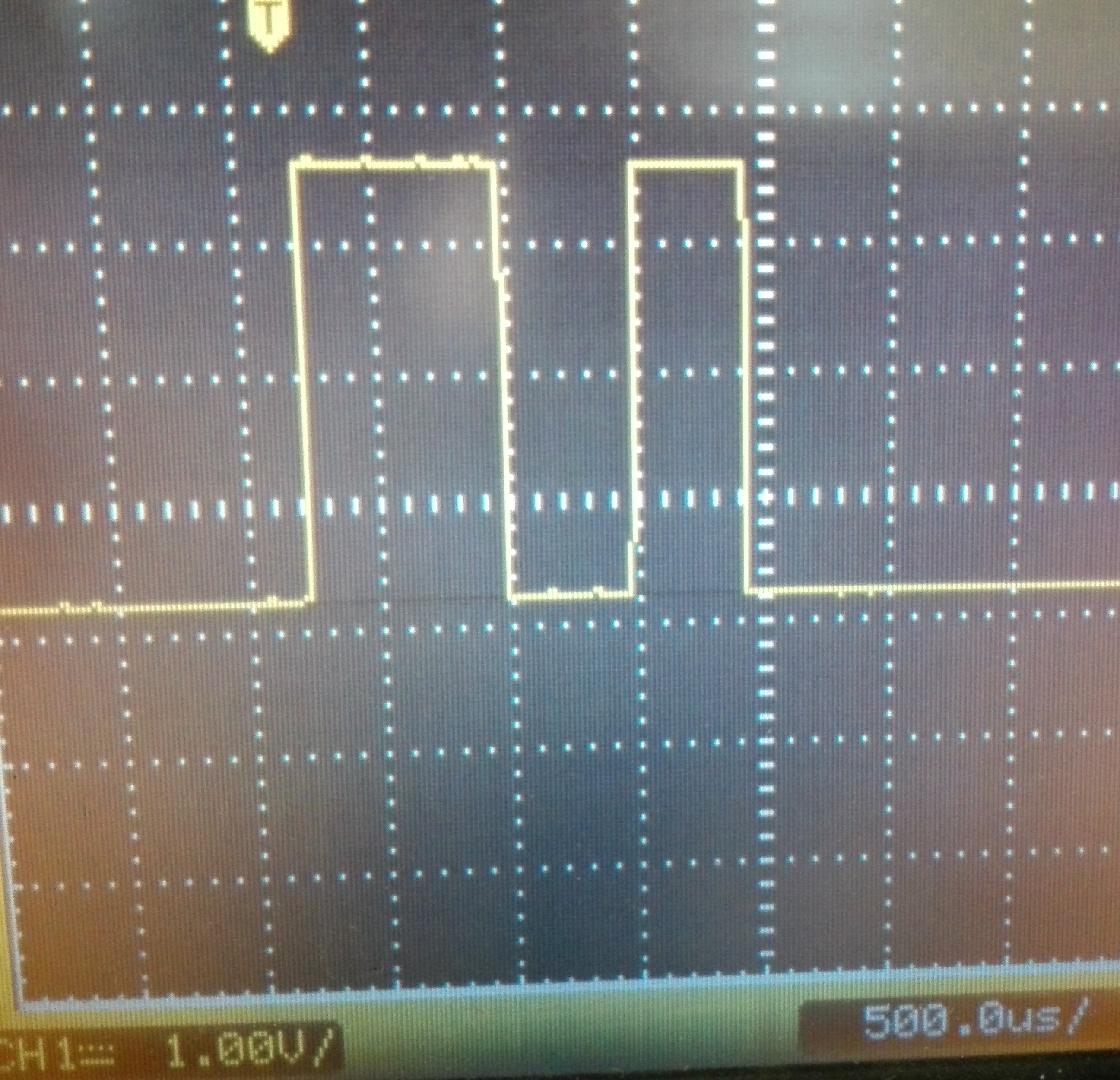

  • Hi Yordan,
    I used the scope to measure the signal, that signal didn't change.
    Could you follow my step to check, thanks.
    B.R.
    Joe

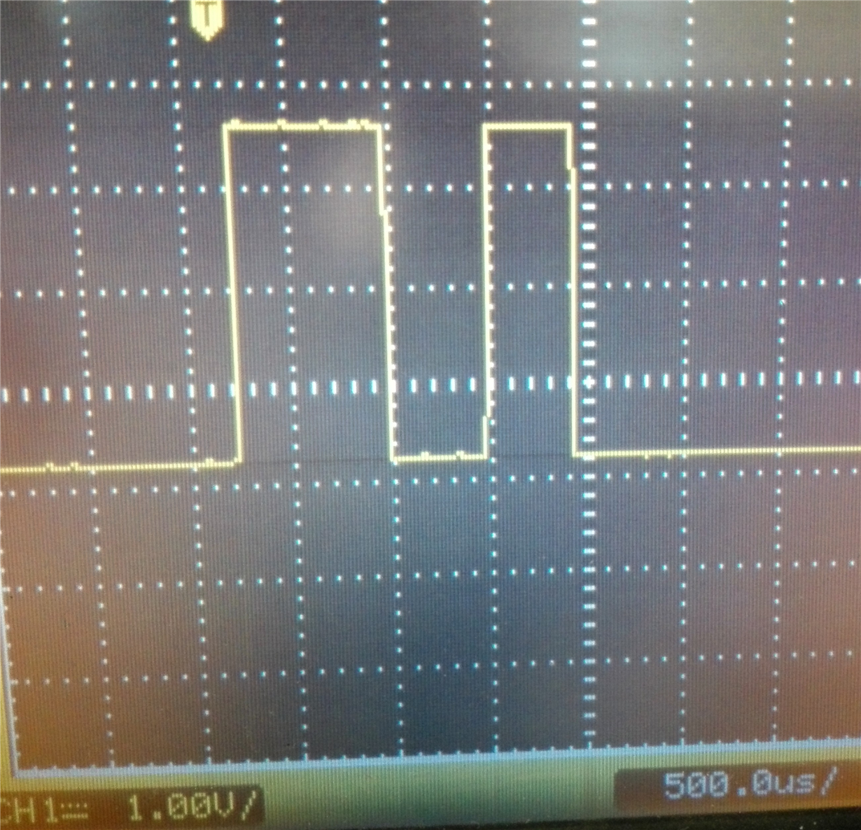

  • Hi Joe,
    My setup is beglebone black, with SDK8.0 running on it, NO modifications to the source code.
    I follow the steps described here: for gpio46. Gpio46 is muxed on P8_16 (gpio1_14).
    I run a simple script, which consist of a couple of echos:
     echo 1 > /sys/class/gpio/gpio46/value
     echo 0 > /sys/class/gpio/gpio46/value
    The result on the scope for gpio1_14 is:
    As you can see gpio1_14 pin is toggling.
