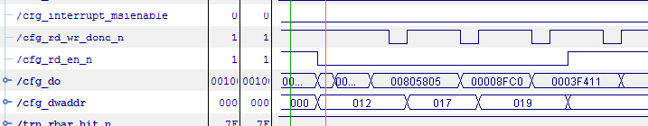

When I monitor this access with ChipScope, no activity happens within FPGA. I do monitor cfg_rd_en_n, cfg_rd_wr_done_n, and trn_rsof_n as triggers. So, again, upon that code execution, no activity happens in FPGA. Moreover, MsiCap structure reads as all zeros, though MSI capability should identify itself with capId=0x05. Because of these two facts - no activity and zarro value read I suspect that reading registers does not happen properly.

Next, if I attempt reading of Command register, still no activity happen in FPGA, and only write to Command register I see activity in FPGA. The following code
StatusCmd.busMs = 1;    // Enable bus mastering
StatusCmd.dis   = 1;    // Set DIS to disable Legacy Intr --> use MSI
StatusCmd.resp  = 1;
StatusCmd.memSp = 1;
if ( pcie_RET_OK !=  Pcie_writeRegs(handle, pcie_LOCATION_REMOTE, &setRegs) )...
triggers the following activity in FPGA
cfg_rd_wr_done_n validates output on cfg_do when asserted low. cfg_dwaddr is address of config space registe being accessed in DWORDS. So address of 012 is 0x048, which is origin of MSI capability record, and 0x00805805 is value of that register being read. The 05 in LSbs is MSI capability Id. Just few para above attempt to read MSI capability returned zero there. Next 58 is pointer to the next record and seems valid, but it was zero in attempt to read this capability before. Within 0080 th only bit asserted is capability to generate 64-bit addresses. The LSb of that field is exactly msiEn bit and it remains zero, i.e. capability was not activated.
Access to 017 (0x5C) is PCIe capability and seems malformed, as C0 capability Id seems to be invalid. Access to 019 (0x64) is to PCIe Link capabilities and values there seems reasonable.
So after all, my major problem is that I cannot activate MSI in FPGA, as it seen from MSI capapability output and from cfg_interrupt_msienable signal. ANother concern is that Pcie_readRegs() seems to not trigger actual reads on the endpoints.
