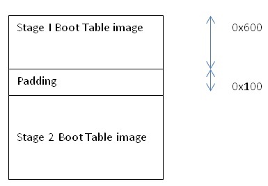

    I suppose your question regarding values  of read_addr_msw and read_addr_lsw is regarding the values you need to populate for those fields when you load a new boot parameter table in your first stage after the DDR has been initialized. For this you need to format your boot image/boot media appropriately. If the boot table for your first stage end at 0x5ff then you could flash your second stage image 0x700 and then program your read_addr_lsw to 0x700 and your read_addr_msw to 0x0000. The field represents 16 bit or 24 bit address field where the boot ROM would look for the boot image. Your first stage always should reside at address 0x00000000 on the SPI flash.
    In order to make sure your boot image is formatted correctly. Make sure it looks like this I have drawn this for the example provided above.
    All of your first stage code should run from either DSP internal memory or the MSMC memory. After your first stage boot completes and your DDR initialization is completed your code can be loaded in the DDR memory. If you plan to re-enter the boot ROM ensure that the boot magic address for the boot the boot core is zeroed out beore you re-enter the boot ROM. The boot ROM renetry address is 0x20b00008. After you re-enter the boot ROM the boot ROM will use the custom parameter table that you loaded in your irst stage in order to read the second stage from location 0x700 and then load the code into DDR.
