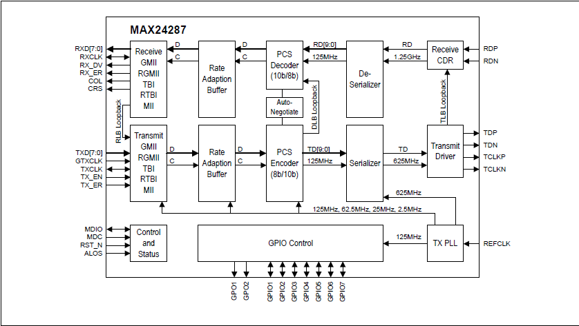

There are 3 loopback modes availble in the phy, to test and diagnose faults (see picture below):
*) Diagnostic loopback to test the MII/RGMII/TBI bus  (loops tx from encoder back to decoder without deserializing-serializing process) - Data is not exiting board
*) Terminal Loopback to test Serializer and CDR (data recovery mechanism), loops back data from tx de-serializer to rx-serializer - Data is not exiting board
*) Remote Loopback to test the differential input/output of of the phy, in this mode the rx line is looped into tx -  Data cannot enter the board, used to test remote connection
I have tried to test the phy with remote loopback (connects external rx line to tx), When i pinged from my computer with this loopback on, i have seen each ARP duplicated in wireshark (even though the second was trimmed from 0 padding - so was basically 9 bytes less, but i guess that normal encoding/decoding operation)
I have tried to test the phy with diagnostic loopback,  which isolates the rgmii interface (it loop the tx back to rx, straight from encoder to decoder, without going through serializer and CDR(data correction) ). So in this mode the tx is just looped back immediately to rx without even deserialzing. When i send packets in this mode (using pktgen), i can see tx counters going up (even though there are some errors and dropped, but most are goodpackets), and the RX has just THE SAME problem, no rxgoodpackets, only rxaligncodeerrors.....
There was no point in trying Terminal Loopback, as the terminal loopback is further after the Diagnostic loopback, so if diagnostic loopback don't work, the terminal will definitely won't work.
So after trying the loopback, my conclusion is that the phy is correctly communicating with neighboring devices. But is not correctly configure from the board side.
