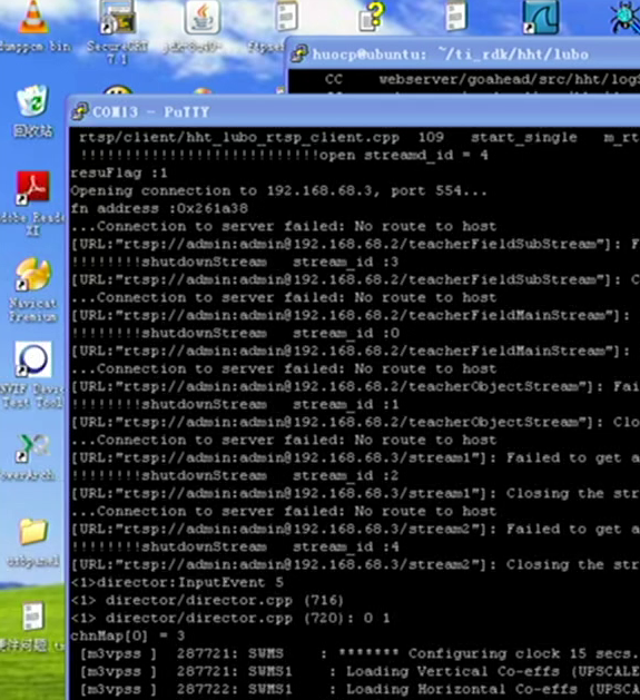

Image captured by DM1868 is blurry
I'm using DN8168 to capture from computer video card, but quality of image is very bad.
If replace DEI link with a scaler link, image is OK, but framerate is low, a lot of frames is lost! And, when i set mcfw link to mulit-panels, the quality of image is also changed to bad.
Thanks!

  • Hi, Margarita
    I'm using RDK V04.00.00.03, and my usecase is based on multichhd_vcap_venc_vdis.

  • Below attached files is my image, usecase  source and run log, Anyone can help me? Thanks!

    ...Connection to server failed: No route to host
    [URL:"rtsp://admin:admin@192.168.68.2/teacherFieldMainStream"]: Failed to get a SDP description: Connection to server failed: No route to host
    !!!!!!!!shutdownStream   stream_id :0
    [URL:"rtsp://admin:admin@192.168.68.2/teacherFieldMainStream"]: Closing the stream.
    [URL:"rtsp://admin:admin@192.168.68.2/teacherObjectStream"]: Failed to get a SDP description: Connection to server failed: No route to host
    !!!!!!!!shutdownStream   stream_id :1
    [URL:"rtsp://admin:admin@192.168.68.2/teacherObjectStream"]: Closing the stream.
    [URL:"rtsp://admin:admin@192.168.68.2/teacherFieldSubStream"]: Failed to get a SDP description: Connection to server failed: No route to host
    !!!!!!!!shutdownStream   stream_id :3
    [URL:"rtsp://admin:admin@192.168.68.2/teacherFieldSubStream"]: Closing the stream.
    [URL:"rtsp://admin:admin@192.168.68.3/stream1"]: Failed to get a SDP description: Connection to server failed: No route to host
    !!!!!!!!shutdownStream   stream_id :2
    [URL:"rtsp://admin:admin@192.168.68.3/stream1"]: Closing the stream.
    [URL:"rtsp://admin:admin@192.168.68.3/stream2"]: Failed to get a SDP description: Connection to server failed: No route to host
    !!!!!!!!shutdownStream   stream_id :4
    [URL:"rtsp://admin:admin@192.168.68.3/stream2"]: Closing the stream.
