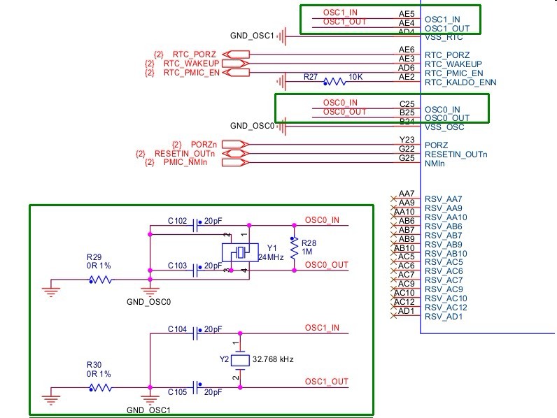

But I could not hear any sounds from headphone, and I could not capture any waveform on MCASP1_ACLKX,MCASP1_FSX,MCASP1_AXR0,MCASP1_AXR1.
The hardware design as the following:
I though the sound data was not be sent to the codec, because after several snd_pcm_writei calls in my application, the kernel function snd_pcm_playback_avail() that in pcm.h would return 0, it indicates the DMA is full.
Can anyone provide some suggestions? for example, how do I to debug the codec, or how do I to modify the codes for making the codec works fine?

    The clock comes from Y3 and the R155 is DNI.
    I had checked the but have not ideas for now.
    Thanks again.
    Kinly
  • Does this 12MHz clock from Y3 go to the AM437X too? To which pin? You need to provide this clock as the McASP master clock source.
  • Hi Biser,
    Thanks your reply very much!
    The Y3 just provide clock source for SGTL5000, does not go to the AM437X.
    There are other two crystal oscillators provide clock for AM437X:
    Sorry but I don't very understand what the means of "need to provide this clock as the McASP master clock source"? which pin in AM437X should I connect to Y3?
    Warm Regards,
    Kinly
  • Please read section 24.3.5 from the AM437X Technical Reference Manual, Rev. B. I don't think your system will work properly if you provide two separate high-frequency clock sources - from Y3 to external codec, and from AM437X internal clock source to AM437X McASP peripheral.
