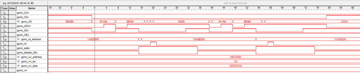

I have a problem setting up the GPMC for synchronous access on a AAD device (an FPGA).
Asynchronous access works fine with these register settings:
WR_MEM_32(GPMC_CONFIG1(FPGA_GPMC_CS), 0x00001100);
WR_MEM_32(GPMC_CONFIG2(FPGA_GPMC_CS), 0x00060A00);
WR_MEM_32(GPMC_CONFIG3(FPGA_GPMC_CS), 0x11030302);
WR_MEM_32(GPMC_CONFIG4(FPGA_GPMC_CS), 0x05044804);
WR_MEM_32(GPMC_CONFIG5(FPGA_GPMC_CS), 0x0008060A);
WR_MEM_32(GPMC_CONFIG6(FPGA_GPMC_CS), 0x06040000);
WR_MEM_32(GPMC_CONFIG7(FPGA_GPMC_CS), 0x00000010);
But as soon as I change the read and write type bits to 1 (synchronous access), I can see the clock being enabled during access, but the address/data lines always stay at 0x0000 (data during write access is set properly, and also data is read - though both will obviously only work on address 0).

    Which processor is this? What is the software that you use?
  • Sorry, i totally forgot to mention that. It's an AM3359 and I'm using CCS 6.
    I'm running the initialisation via GEL file and then access the "memory" (Cyclone V FPGA) via CCS 6 Memory Viewer.
    I can monitor the actual access patterns via Signal Tap through the FPGA.
  • Do you enable the CS before writing: CSVALID=1 (bit 6 in GPMC_CONFIG7)?
  • Yes of course. I also implemented the configurations as menu scripts, so I can change configuration on the fly.
    However, when I use the "synchronous" configuration, I can see the GPMC_CLK being enabled (which is to be expected), but the GPMC_AD lines remain at the same value (either 0 or as in the pictures below at the value of the MSB address word) during the first and second address phases - data (in case of write access) is output correctly though.

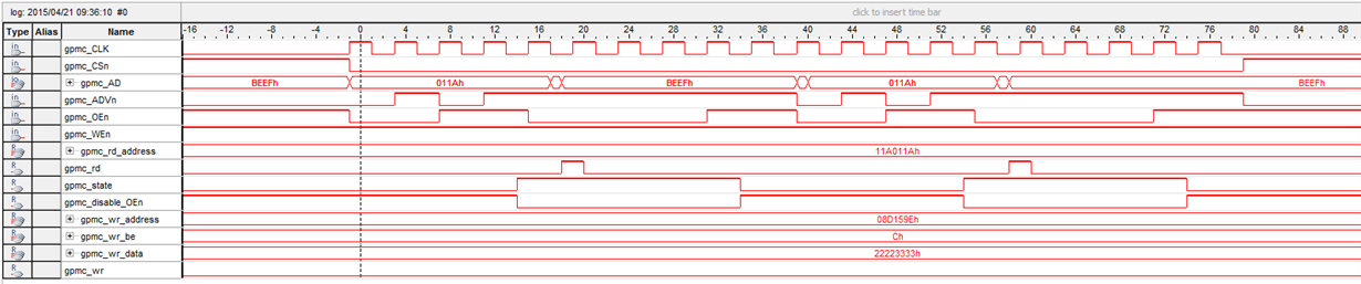

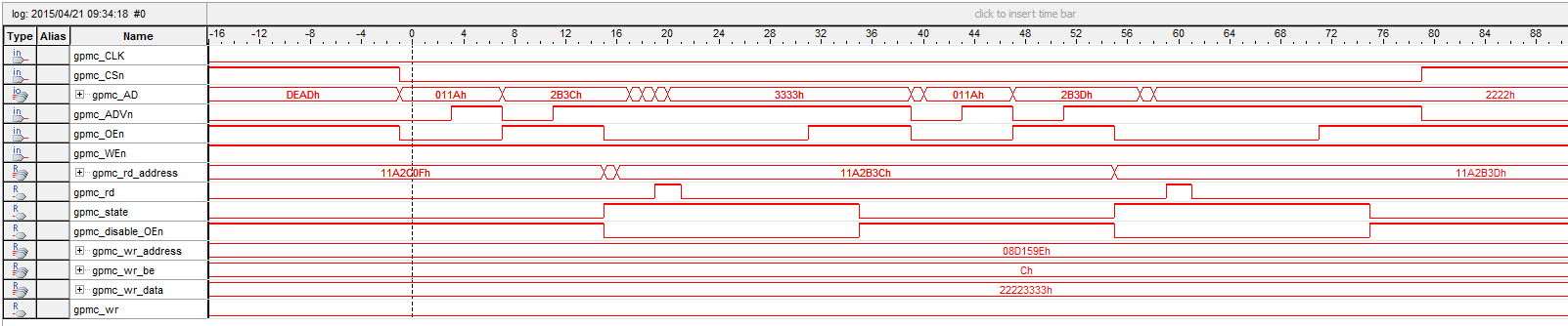

    This is an asynchronous access to address 0x12345678 (16-bit address of the device: 0x011A2B3C):
    And this is the same access to address 0x12345678 (16-bit address of the device: 0x011A2B3C) when the synchronous bits are set:
    (In this case the LSB address word remains at the same value as the MSB address word).
