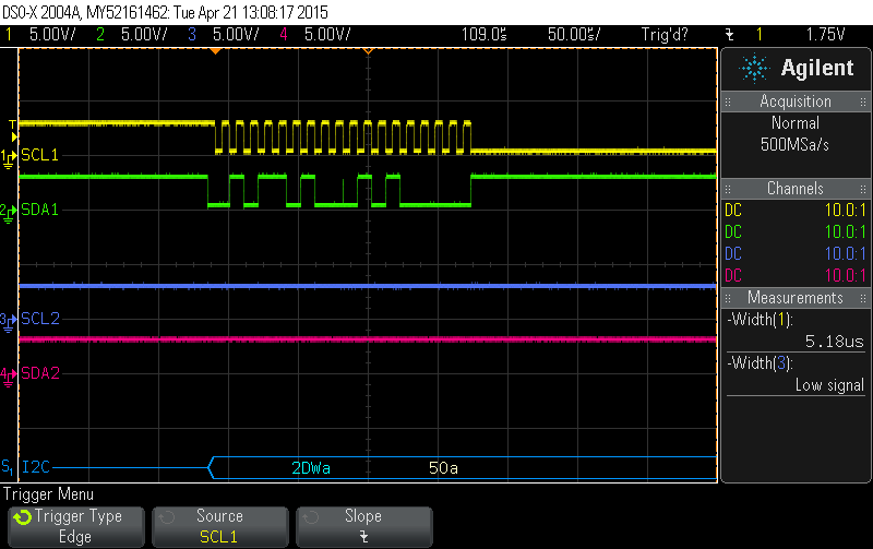

We use three I2C interfaces on an AM3354 with our custom baremetal software. I discovered a strange behaviour on one of the three buses, where a write/read transaction is performed every 50ms (as master).
It generally works without problems, but very sporadic a kind of "clockstretch" occurs, where the SCL line is held low, after writing a value to the slave. The following image shows this behaviour:
Investigating this behaviour, I saw that always the same interrupts are handled as expected, so there is no erroneous sequence of interrupts. The last interrupt handled is always XDR (IRQ_STATUS-register reads 0x0000 4000). While digging a little deeper, I found out that DCOUNT of I2C1_CNT-register and TXSTAT of I2C1_BUFSTAT-register is not 0, although the byte was written to the bus (0x50, as visible in the image above).

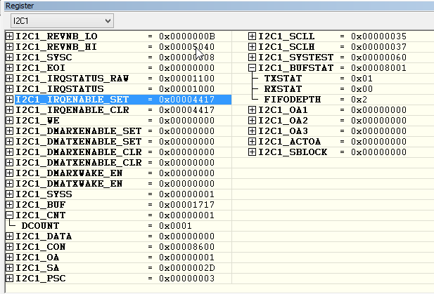

The following image shows all registers at the time of the strange "clockstretch":
Generally I could issue a bus reset (which actually is what I'm doing after a certain timeout), but as there are devices connected to the bus, which do not fulfill the I2C spec regarding the bus reset and might hang after a reset, I have to find the cause for this behaviour.
So what could cause this effect? For me it seems as if writing I2C1_DATA does not cause I2C1_CNT and I2C1_BUFSTAT to update.
Any influence of a slave device, which might hold the SCL low, can be excluded, as measurements on our custom hardware clearly showed that the AM3354 holds SCL low.

    A similar issue has been reported here a long time ago: https://e2e.ti.com/support/arm/sitara_arm/f/791/t/162236 I suggest you check the I2C waveforms carefully, especially whether ACK signal is actually received on the processor side.
  • Hi Biser
    As you can see in the screenshot of the oscilloscope, the slave is addressed correctly and the databyte (0x50) is acknowledged. Every time the SCL gets stuck it is the same. Address the slave (a TPS65910A3 by the way), write the databyte to address the Register to be read from the slave and then it's over.
    When I halt the Debugger after a while, I see that DCOUNT=1 and TXSTAT=1. Why that?

  • I've had a quick look through the waveforms and the register screen shot. The state of the bus looks to be consistent with what you would see if I2C_CON[STP] were never set to 1 at the beginning of the transfer. In other words, if you set STT=STP=1 at the start of the transfer then when the counter gets to zero it automatically sends the stop bit and terminates the transaction. However, if for some reason you did NOT set STP=1 at the start of the transfer then at the end of the transfer the I2C controller would simply hold SCL low (like you are observing).
    So along those lines, once you get into this state can you try setting the I2C_CON[STP] bit through the register window? In your earlier screen shot you showed a value of I2C_CON = 0x8600, so my thought would be to simply poke I2C_CON=0x8602 into the register to see if it then terminates the sequence. That might at least give a bit more credence to my theory...
    And if indeed poking the STP bit terminates the transfer then I think the next order of business will be to determine if/how you end up with a transfer where you have not set the STP bit. I imagine that will involve some inspection and/or instrumentation of the code or something along those lines.

  • I once tracked the values of the IRQSTATUS register, where the following (repeating) sequence is visible:
    0x0000 0004
    0x0000 4000
    0x0000 1004
    0x0000 3000
    0x0000 0004
    As you can see in the screen shot of the registers above, the IRQSTATUS register has the value 0x0000 1000. So somehow it seems, as if the ARDY bit does not get set.
    In our driver we expect this bit to be set, as we then terminate the current transaction (in this specific case it would be the communication visible in the oscilloscope screen shot). After that the second transaction would be performed, where data is read from the slave and STP set afterwards.
