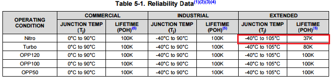

Our customer wants to use 1GHz version of AM3352 in their industrial application.
And the required temperature range is -40°C to 90°C(industrial).
We are confused there there is no option of device selection for
1GHz(nitro) @ Industrial temperature range.
The only option we have is to choose Extended (-40°C to 105°C)
in which case the Lifetime(POH) is reduced to extremely low (37K).
Which indirectly means we cannot choose AM335x (1GHz) for industrial applications.
