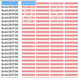

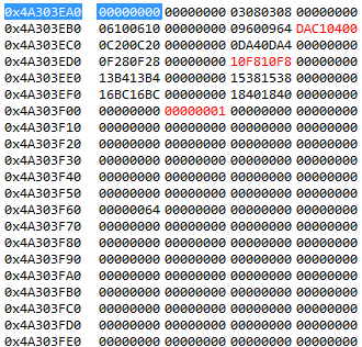

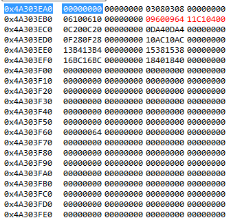

                Can you share the memory dump form CCS starting from location 0x4a303ea0 before and after TxPacketEnqueue gets called?
    Prajith

    Sorry I didnt get how to attach files, so I post some pics
    At reset:
    Before TX:
    after TX:

  • Damian,
    Here the entry at 0x4a303ed8 and 0x4a303eda are the read and write pointers of Port 1 Queue 4. It is changed from 0x10ac to 0x10f8 . It indicates that the firmware has detected the packet and sent it out. Here total bytes sent out will be ( 0x10f8- 0x10ac) /4 * 0x20 = 608u bytes. I don't see anything wrong here.
    If you put break point in TxPacketEnqueue and allow only single packet and get the memory dumb , you can compare the number of bytes enqueued by driver and the number sent out by firmware.
    Still not able to understand why you cant see it in wire.
    Prajith

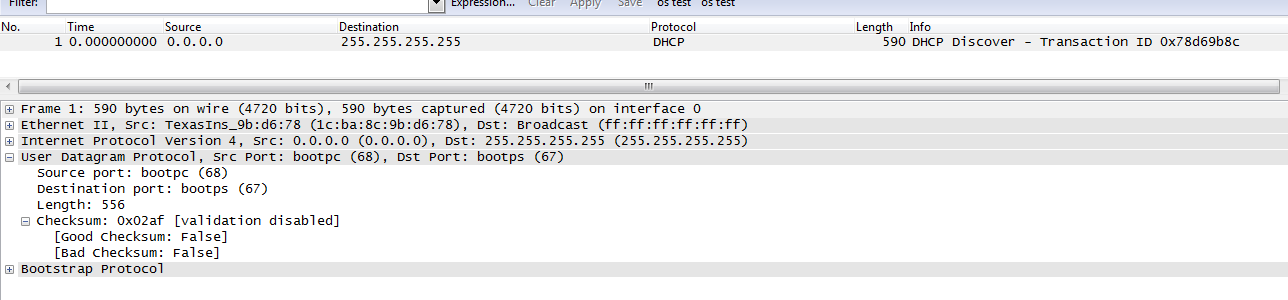

  • Hi Prajith,
    "lengthOfPacket" inside of TxPacketEnqueue  is 590 byte every time. I checked the frame content with wireshark and its correct.
