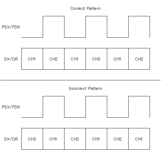

Problem with McBSP and EDMA3.
Channel reversal is occurred about once in five times.
Data corresponding to FSX/FSR is reversed as seen in the pictures below.
Transfer format is I2S(32bit, 2ch).

  • Hi Masakata,
    Welcome to E2E Forum. Thanks for your post.
    Try to probe the CLKS. You need to confirm that clock is continues.
    I suspect clock synchronization can be the issue.
    Also try with internal McBSP clock , make yourself ensure that proper internal synchronization happens.
    If the external device provides the bit clock, wait for two CLKR or CLKX cycles. If the McBSP generates the bit clock as a clock master, wait for two CLKSRG cycles. In this case, the clock source to the sample rate generator (CLKSRG) is selected by the CLKSM bit in SRGR and the SCLKME bit in PCR.
    Please follow each step as mentioned in Technical Reference manual.
    section 24.2.12.1 (General Initialization Procedure)
    Also probe SRGR (Sample Rate Generator Register) and check if you feel any weird behaviour.

  • Hi Arvind,
    Thanks for your reply and I'm sorry for the delay.
    The problem in TX seems to be resolved by waiting 2 clock cycles,
    but the channel reversal in RX is still not resolved.
    My clock source setting is below.
    * The McBSP generates CLKX and CLKFSX.
    * The external device provides CLKR and CLKFSR.
    The waiting time is required to be exactly 2 clock cycles?
    Is there any other point to check when the receiver is used?
