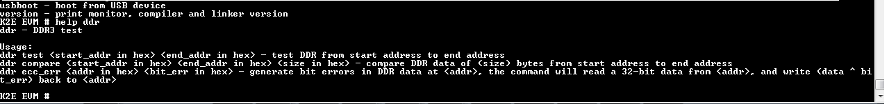

    I would suggest you to boot the u-boot on 66AK2E EVM and check using the "help" command or "?" . For example, like below:
    The following are the tests you can perform related to DDR
    Usage:
    ddr test <start_addr in hex> <end_addr in hex> - test DDR from start address to end address
    ddr compare <start_addr in hex> <end_addr in hex> <size in hex> - compare DDR data of (size) bytes from start address to end address
    ddr ecc_err <addr in hex> <bit_err in hex> - generate bit errors in DDR data at <addr>, the command will read a 32-bit data from <addr>, and write (data ^ bit_err) back to <addr>

    You can find maximum driver support which you mentioned in both u-boot and Linux as well.
    You can find out that information from the screen shot given by Shankari.
    I2C -> i2c command support is available.
    SPI -> sf command support is available.
    EMIF -> nand command support is available.
    UART -> debug log.
    PHY -> tftpboot,dhcp commands are available (Ethernet).
    GPIO -> I hope, you can access the GPIO inside the u-boot code.
    EDMA -> Need to check.
