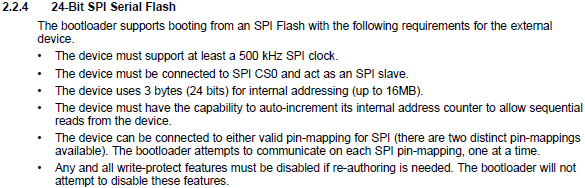

Please let me confirm the following question just in case.
[Question]
 If C5535 meets the following requirements, does the C5535 support the boot with the SPI flash even though the serial Flash is  "Serial NOR Flash"?
And if I show the SPI NOR flash which my customer will use, would you please check whether it will use for boot of C5535?
If you have any questions, please let me know.
Best regards.
Kaka
  • Hi Kaka-san,
    Yes, C5535 supports the boot modes (SPI ) with both SPI 16-bit EEPROM & SPI 24-bit Flash
    It needs to be ensured that 24bit SPI flash device meets all the requirements(including timing) specified in the C5535 bootloader App notes / Datasheet / TRM.
    Hope this clarifies.
