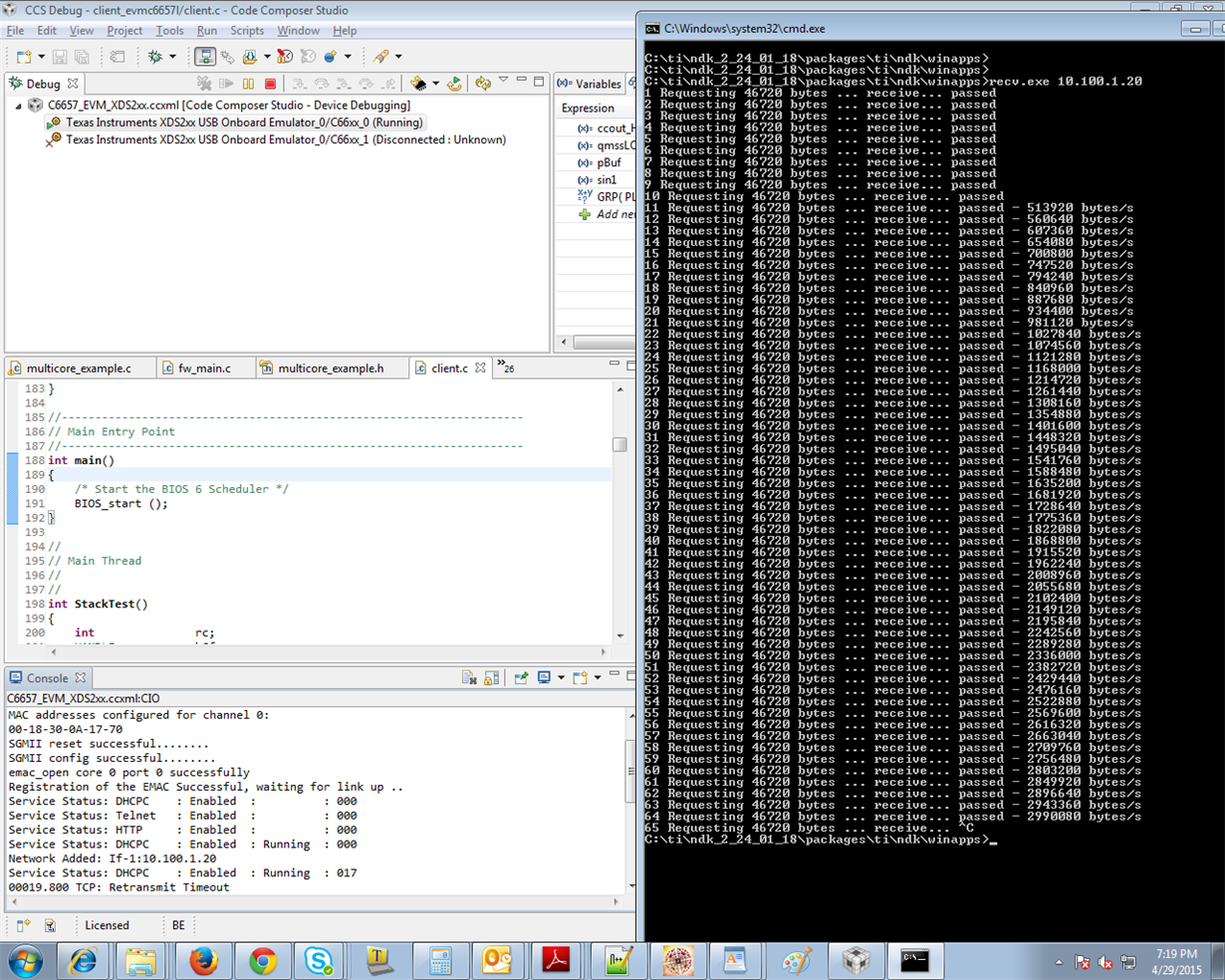

    i am using c6657 DSP.The mentioned projects by you are only for C6678. Please tell me which projects i can use for my C6657 DSP.
    Ram.
    Yes, you can use the client example with winapps.
    C:\ti\mcsdk_2_01_02_06\examples\ndk\client\evmc6657l
    C:\ti\ndk_2_24_01_18\packages\ti\ndk\winapps
    (2) finally i want to connect two custom boards with LAN cable(RJ45) to both Ethernet ports, and use one DSP on one board as the transmitter and the other DSP on the second board as the receiver and communicate both and sending packets from one to other. has any one tested like this?
    Yes, you can use this client application with static IP mode.
    You have to assign static IP mode for sender board and need to assign different static IP for receiver board with the same netmask.
    I ran client example on C6657 EVM board with running winapp send/recv application.
    ti.sysbios.heaps.HeapMem: line 294: out of memory: handle=0x8ea788, size=5120
    xdc.runtime.Error.raise: terminating execution
    Try to increase the heap size in *.cfg file.

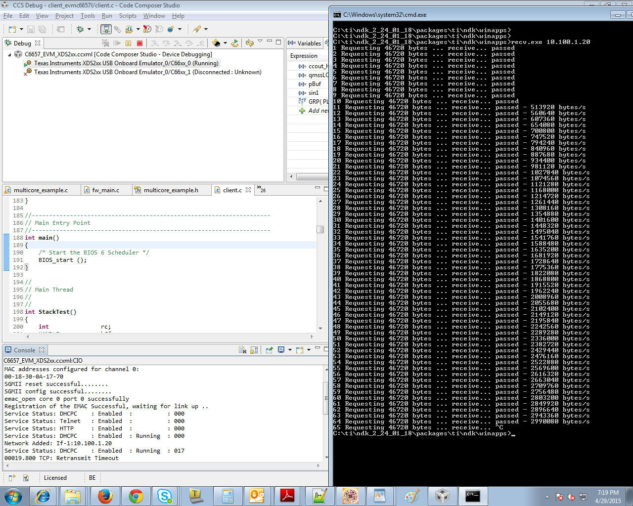

    Do you have any idea, why recv.exe is not working?
    Ram.
    The programs in the folder ->C:\ti\ndk_2_24_01_18\packages\ti\ndk\winapps which are generating different exe files has different port numbers.does this influence when i am trying use recv.exe?Why different programs has different port numbers?
    for eg: send.c(PORT 1001)
    testudp.c(PORT 7)
    recv.c (PORT 1000).
    Ram.
    Sorry for the delayed response.
    Able to ping the IP address on your windows while running "recev.exe", hope it worked since able to connect IP through webpage.
    What are the sw changes you have done in NDK client example code for your custom board ?
    No, do you have any C6657 or C6678 or C6670 EVM board with you ?
    I'm able to run all the winapps with NDK example code and not seen any issue.
    What are all the hw changes (related to ethernet) you made on custom than C6657 EVM board ?
    Please see my answers.
    I changed the intialization of my custom board to configure the PLLs for different peripherals and i hope it does not have the problem.
    second i changed client.cfg file, may be this has some influence. in the evm client.cfg file  heap and emaccomm are allocated in DDR3, i am doing it in L2SRAM.
    when i do like evm cfg file my program is not coming to main, i don't know why. i am giving my clien.cfg file and the platform.xdc what i am using.
    I have one c6657 evm board with me i havent tested the ethernet communication on it until now. i directly came to my custom board.
    do you think i need to test on the EVM board?
    we have other PHY (88E1512) not like EVM board.
    If we have done in EVM too, you would get some better understanding and you can see the expected behavior.
    BTW, I will check your *.cfg and let me update.
    Do you have any other hw changes like RAM size, make etc., ?
    It may cause this behavior due to PLL configurations of DDR.
    i am also giving my client.c file which i modified, please look into this one, as i changed the stacktest().please look into this function if i need to add some extra things, to run recv.exe under winapps.
    client (2).c
    Ram.
    i tested with the EVM board, it works completely fine. And i see the same result as you got, recv.exe is working. but when i use my custom board, when i use the same .cfg file which is  mostly allocated for DDR3. i am not coming to main() function. i think if i am able also run client program with original client.cfg file may be it works.
