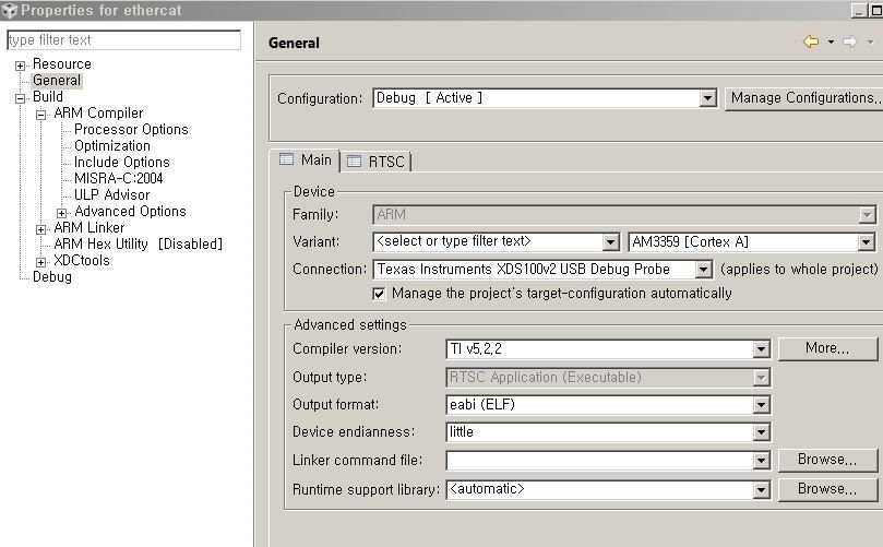

  • Linker.cmd file is just reference for possibility of my invalid setting. Linker.cmd file is in project folder but project is not use the file.
    I already tested to set the linker.cmd file at advanced setting ( linker command) of properties, then there was other undefined error.
    Above build log is the result that didn't set the linker.cmd file, and if set linker.cmd file , it occurred other error.
  • When you say "linker.cmd" I think you are referring to one of the files you posted in your first message. I think you should include one of them in the project. I am not sure which one because I don't know exactly what's the difference between them, but they are defining some symbols that you need. If they cause some other errors when included, then these errors have to be fixed some other way rather than excluding these necessary files.
    I also asked you earlier to post the content of the generated file configPkg/linker.cmd. It's in your Debug or Release directory. That file should resolve some of the undefined symbols, so I need to see it to find out why it's not resolving these symbols.
