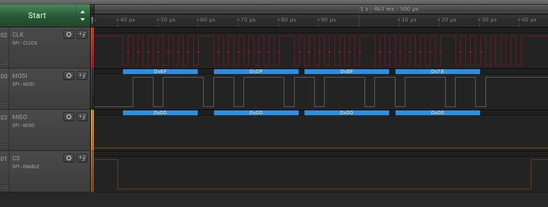

I'm trying to have the McBSP2 on our C5409 do SPI as a master to a serial eeprom.
I'm getting pretty close, but I doesn't quite work. If I send only one byte it works, but when I try to send more than one bytes, all the bytes but the first one have only 7 bit in them!??! (Even though I wait for TEMPTY. I tried TRDY too, with no luck).
I do not use DMA or IRQ, and I have the same behavior from 400kbps all the way to 2Mbps. I haven`t tried any faster.
Anybody has seem something like that before? Any leads on what I might try or check?
