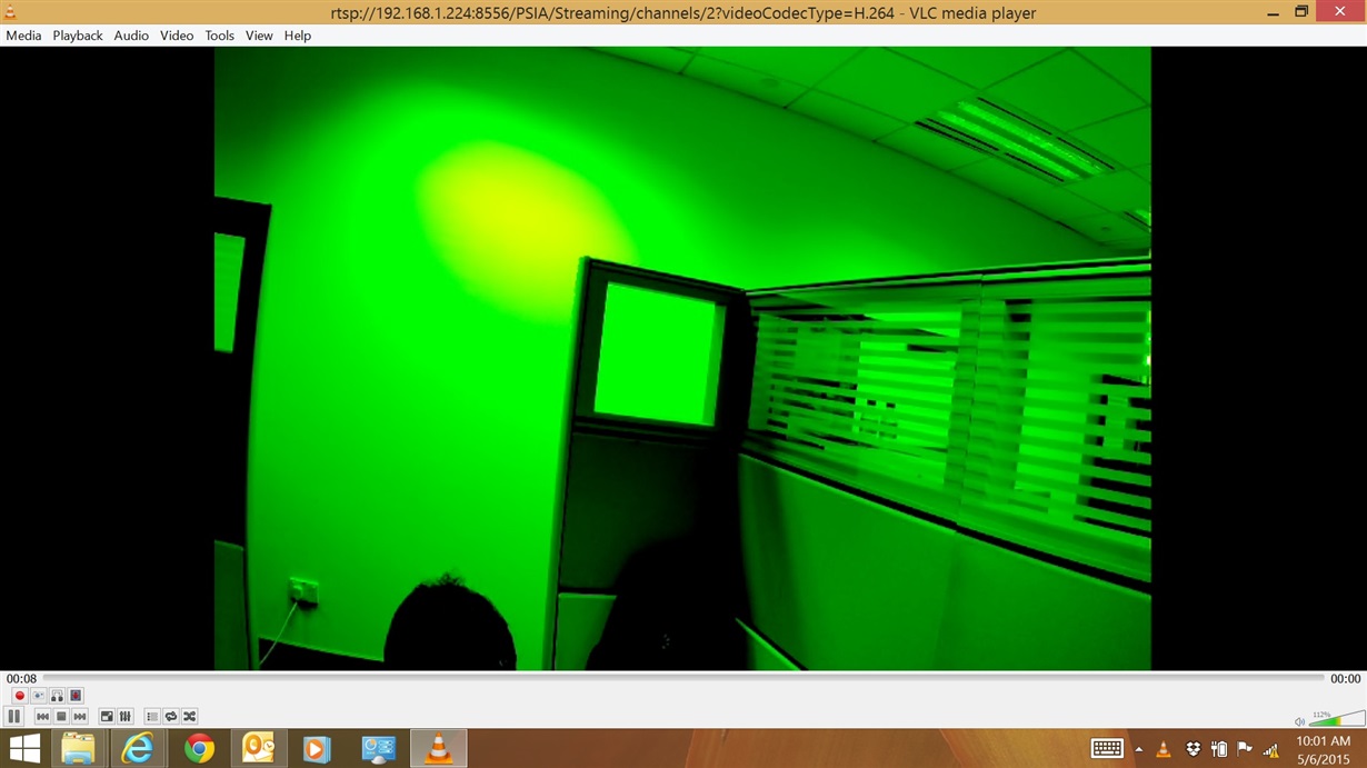

Video Greenish with TI2A
Other Parts Discussed in Thread: DM388, DM385
RDK : IPNC RDK v3.8
Cam : DM388
Sensor : IMX136
I downloaded fresh IPNC code and built for full feature demo. By default , APPRO2A  is selected. The video looks fine.
I changed the 2A  to  TI2A ( by selecting TI2A   in the web GUI  selects APPRO2A internally, don't know why)  by making
pObj->aewbVendor = AEWB_ID_TI;  in ti_tools/iss_03_80_00_00/packages/ti/psp/iss/drivers/alg/2A/src/issdrv_alg2AApi.c  (IssAlg_capt2AProcess())
The video is greenish. I made sure that sensor board vendor is Appro  and used it in the Rules.make. Attached is the screenshot of the video.
Request  some experts  to look into this issue.
Best regards
JK

    What is your requirement?Do you want to enable both Appro and TI 2A for DM388 + Appro IMX136 combo?
    By default,only Appro 2A is enabled for this combo, and if you change to TI 2A via web GUI then it gets forced back to Appro 2A.
    If you want to run both 2A algorithms then you need to remove the constraint in the ..\ipnc_rdk\ipnc_app\sys_server\src\Makefile file:
    ifeq ($(SENSOR_BOARD_VENDOR), APPRO)
    ifeq ($(IMGS_ID), IMGS_SONY_IMX136)
    #C_FLAGS += -D_ONLY_APPRO2A
    endif
    endif
    As far as greenish image is concerned,pl. make below change in the ..\ti_tools\iss_03_80_00_00\packages\ti\psp\iss\drivers\capture\src\issdrv_captureApi.c file and check:
    gIss_captCommonObj.pIssConfig->ptH3aAewbParams->ptAewbPaxelWin->nHPos = 32;    //31;
    Pl. note that the TI 2A is not tested with DM388+Appro IMX136 sensor combo.
    regards,
    Anand

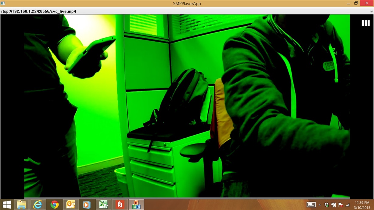

  • Dear Anand,
    I wanted to use TI2A. I made both changes, and ensured that TI2A is selected.
    But still the image is greenish.
    JK
    I am running TI 2A on DM388+LI IMX136 combo.
    If i make 'gIss_captCommonObj.pIssConfig->ptH3aAewbParams->ptAewbPaxelWin->nHPos = 31;' then i observe the greeish image:
    Conversely you should see proper image by making gIss_captCommonObj.pIssConfig->ptH3aAewbParams->ptAewbPaxelWin->nHPos = 32;
    If there is no apparent change in the video it means the change made is not getting reflected.
    Can you send me your changes?
    If you want to run TI 2A algorithm then you should have used LI IMX136 sensor board and driver.
    regards,
    Anand
  • Dear  Anand,
    With   C_FLAGS += -D_ONLY_APPRO2A  to   #C_FLAGS += -D_ONLY_APPRO2A  change, I can  now  select  TI2A.
    Attached is  issdrv_captureApi.c and  the console logs. See  the snapshots take  before  and  after  your  changes. There  is slight  change.

    Thanks a lot for the fix. The image looks  better now. I will  keep it for testing over this weekend.
    Best Regards
    JK
  • Hi Anand
    We  have  tested  the  video  quality  at  outdoor  settings(With sunlight). It looks  very  bad. See  the  attached  image .
    Can  you  pls look  into this  issue ?

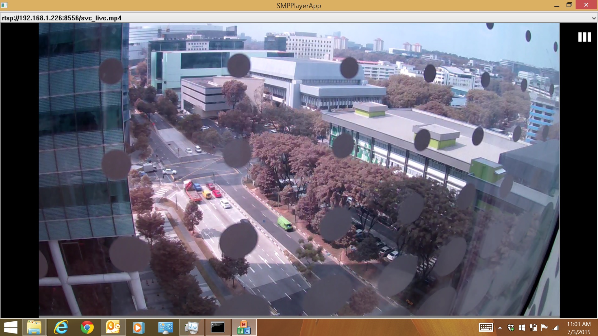

  • Attached two more images. One is image scenery taken by  phone  and  other one  is  from ipcam (TI2A)  snapshot of the same  scene. The green plants are  completely  changed  in  color.
    Your image is over exposed.
    Reduce the value of 'gTi2aControlParams.minExposure' for your sensor in the ;..\ti_tools\iss_03_80_00_00\packages\ti\psp\iss\drivers\alg\2A\src\issdrv_algTIaewb.c' file.
    You can make it as low as 200 usec.
    regards,
    Anand
  • Hi Anand,
    After making  'gTi2aControlParams.minExposure = 200;  the  over exposure  issue is  improved. But the  green plants  are still  purple. see  the image  below.

  • Hi  Anand,
    Few more observations.
    1. The green tree leaves  turn  purple  when   sunlight falls  directly on it. The more the  sunlight, the more  the purple  color.
    2. The tree leaves under the  shade  are better. See the picture  below. Attached  the  original scene  for  reference.
    Best Regards
    JK
    The Appro IMX136 sensor board has an IR cut filter.
    Pl. check with Appro on how to use it.
    Also you can remove the filter and check the effect.
    regards,
    Anand
  • Hi  Anand,
    Appro IMX136  sensor  board  do  have IR cut filter  inside. The  default GUI  config  setting  is "Night" mode, which cannot  be  set  to Day  mode  by DM388  GUI.
    Instead , I used DM385 kernel  and file system to  change it to "Day"  mode. (Day  mode --> IR cut  filter included,  Night mode--> IR cut filter NOT included).
    Once  this  is  done, I am getting good video( snap shot attached). Appreciate your  help.
    Best Regards
    JK
