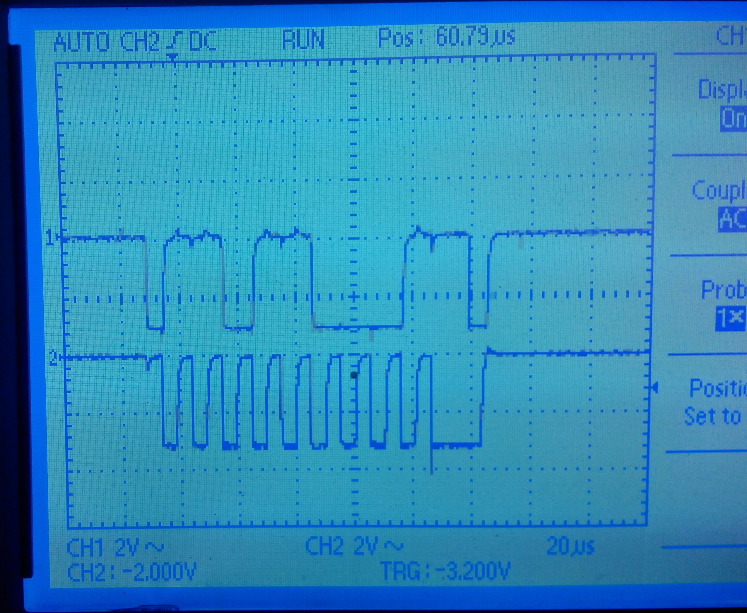

I use CCS 6.0.1, DSP/BIOS 5.42.1.09, processor OMAP-L138 (DSP only), C6748 BIOS PSP 01.30.01.
At execution of the following commands:
wBuffer [0] = 0x07u;
dataBuffer.slaveAddr = 0xECu;
dataBuffer.buffer = *wBuffer [0];
dataBuffer.bufLen = 1u;
dataBuffer.flags = I2c_WRITE | I2c_MASTER | I2c_START | I2c_STOP;
status = GIO_submit (i2c_outHandle, IOM_WRITE, *dataBuffer, *dataBuffer.bufLen, NULL);
Return value variable status = -2. In figure it is shown the oscillogram on lines SCL (the bottom curve) and SDA (the top curve).
That is, on Slave its address is transferred only and value 0x07 is not transferred.
Help to solve a problem.

    Are you working on EVM or custom board?
    Why you have changed the slave address, are you interfacing an external slave device with different address?

    As you are saying you have changed slave address(0xECu), and also it is been transferred. But waveform doesn't look like it has transferred slave address correctly.
    I suspect slave is not configured properly.

    What is your I2C slave device ?
    Could you please try "0x76" as slave address and see.
