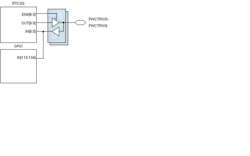

I just want to know how to use the PWCTRO0~3 and PWCTRIO0~6 pins.
From the datashet, I know ,The PRTCSS will work in extern reset mode if the PWRCNTON input pin is held at 1 and the PWRST pin is held at 0. So I did. I use the pins for general I/O, so I up them. But I don't konw how much does the resistance ? I use 10K, but I can't set the pins to low.
So I need help. How can I use this pins ? Is it the resistance I used too much?

    I have saw the PRTCSS user's guide. But in my board, I can't control the PWCTRO0~3, I can control the other pins .
    I uesed the 10K resistors, when the power went on, the PWCTRO0 was low, I need high when it powered, So I changed the 10K resistors to 22 resistors, then the pin was high, but I can't make it to low, When I set it to low, I measure it , it is 1.4V, It is always high.
    I also saw the EVMs, but I can't saw anything program about those pins. Those pins were connected to the CPLD, I downloaded the CPLD's program , but the program wasn't control those pins.

  • Jack,
    The PWCTRO[3:0] pins:
    - Are OUTPUT only Pins and can be driven only by the PRTCSS.
    -By default this pins are Output and are driven Low. (The PRTCSS Guide says default value is ‘driven high’ section 4.2.1 PRTCSS guide, but this the default is 'driven low'. The default value of GO_OUT register is not correct and it should be all '0' value).
    -So if they are going to be driven as outputs you don't really need an external pull resistors.
    A 22ohm resistor is definitely a very strong pull resistor and in this case its opposing the default low driven pin.
    The PWCTRIO[6:0] pins:
    -Default value = Input.
    -Can be INPUT/OUTPUT, driven by the PRTCSS.
    -So if they are going to be driven as outputs you don't really need an external pull resistors, but if the pins are to be used as Inputs only and there is no way for the state of the pins to be driven externally by a 0 or a 1 then you will want a pull resistor.
    As PRTCSS GPIOs functionality: The PRTCSS guide shows how to program this pins as GPIOs via the PRTCSSIF registers (2 step process to actually access the PRTCSS registers for GPIO functionality)
    - As generic GPIOs (accessed via the GPIO module) GIO[110:104]=PWCTRIO[6:0] in case the PRTCSS clocks not enable via PSC for PRTCSS.
    Please see the attached diagram.
    regards,
    Miguel
