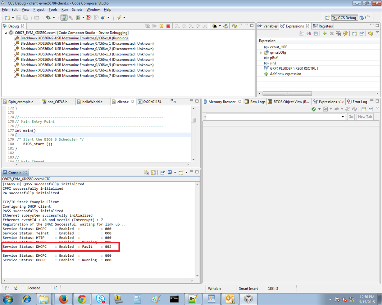

I ran the NDK/Helloworld project on 6678 evaluation board in static IP mode.
Now i want to run this project in DHCPC mode so i turn on the second bit of SW9 and run the program but i face with the following error. What should i do for resolving this problem?
[C66xx_0] TCP/IP Stack 'Hello World!' Application
[C66xx_0]
[C66xx_0] QMSS successfully initialized
[C66xx_0] CPPI successfully initialized
[C66xx_0] PASS successfully initialized
[C66xx_0] Ethernet subsystem successfully initialized
[C66xx_0] eventId : 48 and vectId : 7
[C66xx_0] Registration of the EMAC Successful, waiting for link up ..

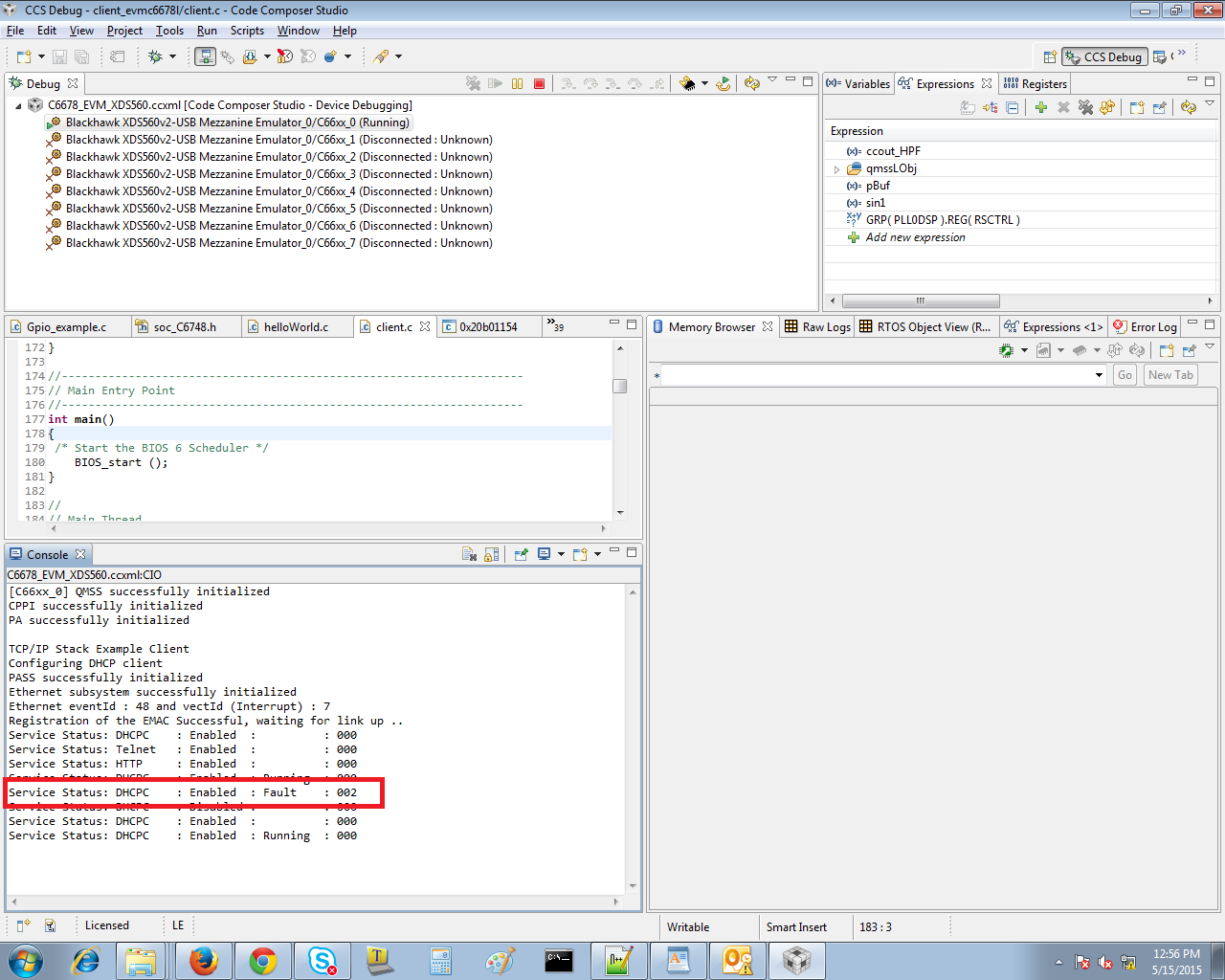

[C66xx_0] Service Status: DHCPC : Enabled : : 000
[C66xx_0] Service Status: DHCPC : Enabled : Running : 000
[C66xx_0] Service Status: DHCPC : Enabled : Fault : 002

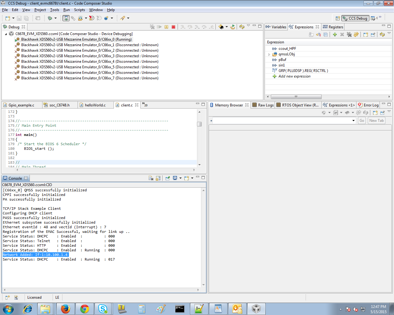

    How did you connect the C6678 EVM board ?
    Do you have DHCP server running on your LAN where you connected the board ?
    Please make sure that you have DHCP server running and getting IP address from there.

    How did you connect the C6678EVM board ethernet cable ?
    Is that connected between PC to C6678EVM board ?
    Or Is connected to network ?
    In your LAN connection, DHCP server would run and you can get assigned IP address dynamically.
    I'm trying to reproduce the problem.
    I've connected the ethernet cable between windows host PC to EVMC6678 board and got the same problem.
    So please make sure about your EMAC connection.
    The above mentioned setup is only for "static IP mode" configuration and not for DHCP.
    You have to connect the C6678 EVM board ethernet cable to the LAN where DHCP server runs and provide the IP.
    Static Mode - > You would set IP manually.
    DHCP Mode - > DHCP server provide the IP automatically.
    Working : Here, I would connect the C6678 ethernet cable to ethernet switch which is connected company LAN where I get IP from DHCP server.
    Not Working : Here, I would connect the C6678 ethernet cable to my windows host PC
    FYI: I'm running "client" NDK application.

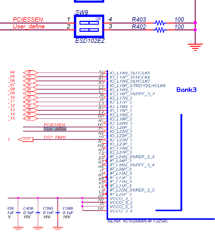

    As per the C6678EVM schematics, that SW9 (user input) pin had been connected to FPGA IO port named as "User_define" so please check with your hw team for how that FPGA IO has been connected on your custom board.
  • Hi
    I checked the schematic and i know the pin tht goes to fpga(spartan3). I do not know that what work the fpga do for switching to static mode?
  • Actually that pin was just IO, in code they would read the status of that IO and decide upon what configuration we can do.
    We can also enable the "static IP" mode with sw change and no hw change.
    Modify like below, this code always runs on static IP mode configuration without considering hw change.
    Try this let me update.
