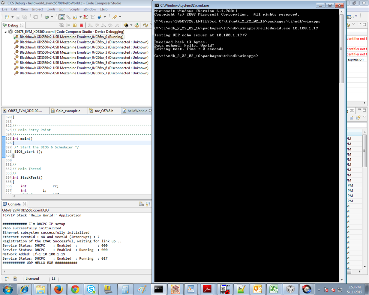

I am using amc2c6670 to test NDK helloworld example.DHCP mode has been closed and the target DSP has a specified IP address"192.168.1.32"
I use CCSv5.3 to load the program and after loading it shows:
[C66xx_0] QMSS successfully initialized
CPPI successfully initialized
PA successfully initialized
TCP/IP Stack 'Hello World!' Application
PASS successfully initialized
Ethernet subsystem successfully initialized
Ethernet eventId : 48 and vectId (Interrupt) : 7
Registration of the EMAC Successful, waiting for link up ..
Network Added: If-1:192.168.1.32
Then i used arp -s to bind DSP's mac address to its IP address.
arp -s 192.168.1.32 xx-xx-xx-xx-xx-xx
After I tried helloworld.exe 192.168.1.32.It shows "recv failed 10054"and DSP can't receive any message.
Any suggestions?Thank you..
