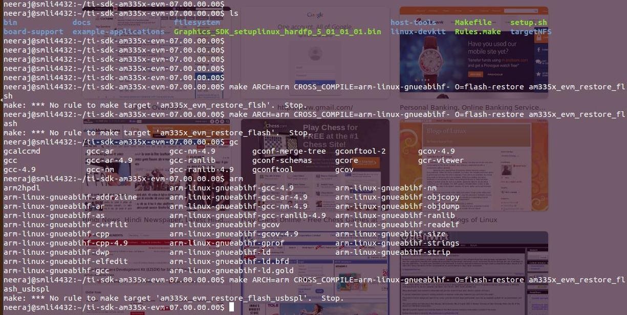

  • Mr. Biser,
        After following the process as explained in the link given by you, there are some errors are occurring. As in link for Ethernet, "flash-restore" in TI-SDK giving error whose snapshot is attached.
    Also in this process while it(SDK) opens the console on "minicom" is having time out for "cpsw" as "cpsw having problem .... TIMEOUT" (approx. string not same as it is there).

  • Hi Suneet,
    I see two mistakes in your work flow:
    1. There is no am335x_evm_restore_flsh.h file in include/configs folder so you won't be able to build for this configuration.
     As stated in the wiki, for booting through CPSW you should use make am335x_evm_config and use the spl/u-boot-spl.bin and u-boot.img files that are produced afther you executed the make command..
    2. If you want to use the sequence:
     host$ make am335x_evm_config
     host$ make
    you should execute those commands from ti-sdk-am335x-evm-07.00.00.00/board-support/u-boot-2013.10-ti2013.12.01 folder
    If you want to build from the  ti-sdk-am335x-evm-07.00.00.00/ folder you should use the sequence:
     host$ make u-boot_clean
     host$ make u-boot
    Also make sure you export the ti-sdk-am335x-evm-07.00.00.00/linux-devkit/sysroots/i686-arago-linux/usr/bin to your PATH variable.
