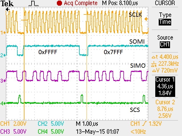

I'm trying to configure SPI slave with dMax.
For slow transfers (rates up to ~1.5Mbps), there is no problem, but, when I set bus SPI speed for 4Mbps ++, the SPI slave (C6727) seems to not be able to output data in time.
For example, in the picture below, I set to transfer 0xFFFF data in 16 bits frame format, but the C6727 could not output the data correctly. Sometimes the master read 0x7FFF from the bus.
I’m using the following setup:
Spi:
Slave mode; polarity 0 (inactive low); phase 1; length 16
dMax:
SPI priority low; eSize 16bits; polarity falling edge
Thank you all,

    Have you verified all your hardware connections and PCB routing is proper ?
    Are you always missing the MSB or random missing ?

  • Hi Senthil,
    I'm getting random mismatches, and they do not always occur in the MSB.
    I've tried to increase the clock frequency using PLL to 300MHz (was 240MHz before), and it helped, but not solved the issue. Now I’m wondering if this delay in SOMI data could be caused by some clock issue or dMax misconfiguration.

  • Hello Senthil,
    Changing the device frequency, I got a little improvement on SPI->MISO timing. The data was output faster and the misread occurred not so often.
    I’m seeking for dMax configuration issue…. Nothing found so far.
    Some update are that I could not get SPI working when using phase=0 on C672x, and, reading the datasheet errata for 1.2 silicon revision, I’ve found that phase=1 should not be used.
    Renê
    Reading the "spru_795d.pdf", I've found that dMax uses 84 cycles to transfer data from SRAM to SPI peripheral.
    Please correct me if I'm wrong, but considering that I was using PLL frequency of 228MHz and peripherals at 114MHz, dMax could use, in worst case, 84/114Mhz = ~737ns to transfer data to SPI, so the maximum SPI transfer rate will be ~1.357Mbps. I conclude that, when I speed up the transfer from ~1Mbps to 4Mbps I got many SPI transfer errors because dMax could not transfer data in appropriate rate.
    When I changed the PLL multiplier to 25 (300MHz), and peripherals 150Mhz, I have some improvement because 84/150M ~= 560ns, and then SPI max rate ~=1.8MHz.
    Is that right???
    Someone ever get dMax and SPI working at higher rates?
    Renê
  • Hello Rene,
    That might be a cause for your SPI transfer error. The dMax SPI controller should be capable to transfer the data at the rate you desire. From the above statements, i guess there should be a limitation on the data transfer rate from the dMax.
    I don't think we have information on the successful C6727 SPI slave interface with dMax.
