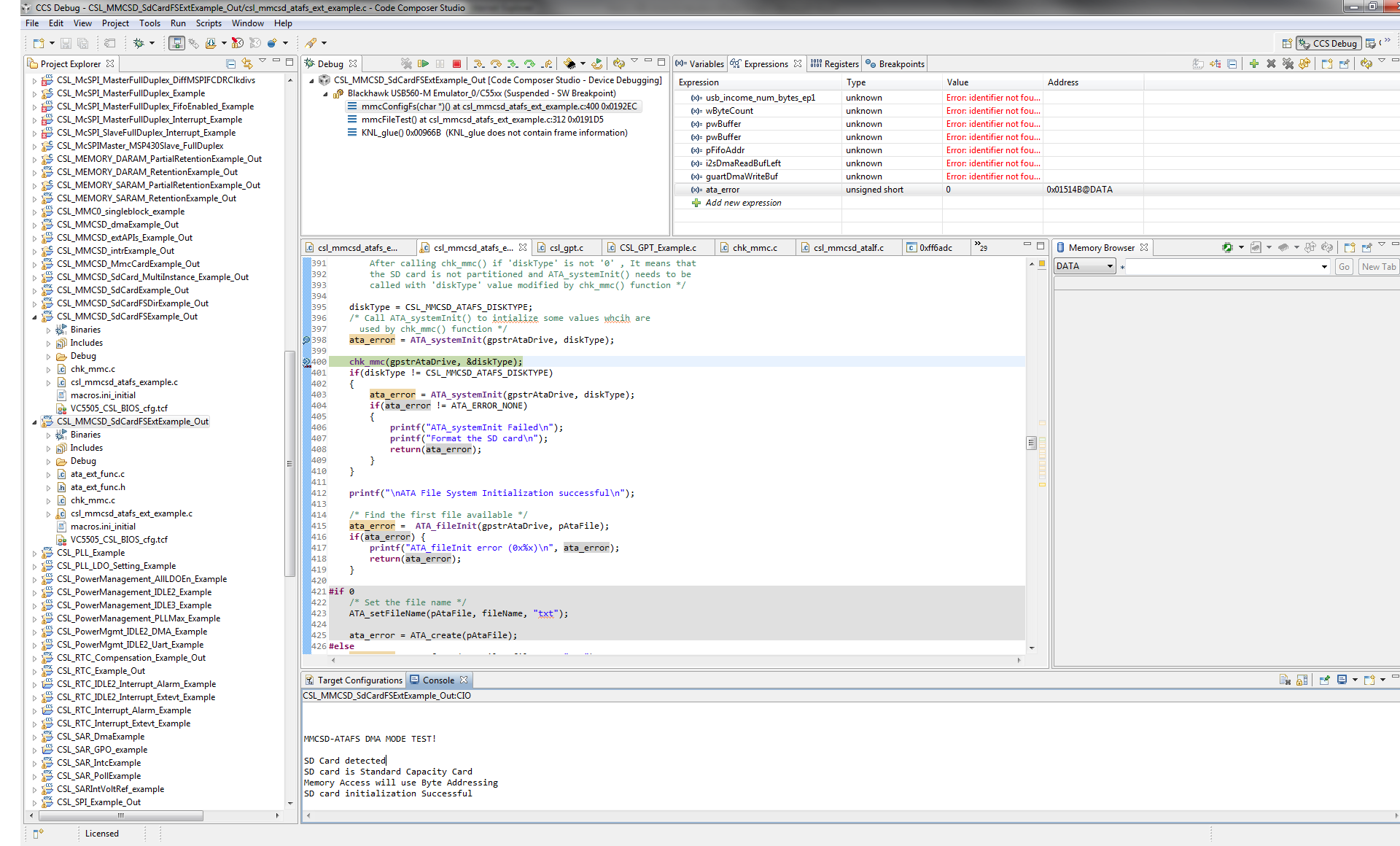

I used two SD cards to run ATA_systemInit in C5515 before I had formatted SD cards.
ata_error = ATA_systemInit(gpstrAtaDrive, diskType);
Card 1 ata_error = 0.
Card 2 ata_error = 768.
Why did the SD card 2 return ata_error = 768?
What is error code 768?
    Are both these SD cards similar types ?

    Can you share more details on which example you were running etc. and let us know if this can be reproduced here ( using CSL example & hardware-EVM ).
     Vasanth
  • Hi Vasanth,
    CSL example : c55_csl_3.03
    hardware : customize
    I found a SD card issue today when I used error = ATA_systemInit(gpstrAtaDrive, diskType);.
    Before the SD card was a good card , the SD card result of error is 0.
    Recently , I used the SD card for testing , program/read/erase and PC format .
    1) The SD card was with the same.
    2) The SD card result of error was 0. (Before 6/23)
    3) The SD card result of error is 768. (current 6/24)
    4) I had used format on Win7 PC , the SD card result of error is 768.
    Why did the SD card error from 0 to 768?
    What is error message 768?
    How to fix the issue?

    I tried the SD card on C5515 EVM , the ata_error was 768 , too.
    Before ATA_systemInit , I call chk_mmc(gpstrAtaDrive, &diskType); to fix ata_error = 768 issue.
    Could you tell me the ata_error = 768 root cause?
    // CCS version : c55_csl_3.04
    // CSL_MMCSD_SdCardFSExtExample
    ata_error = ATA_systemInit(gpstrAtaDrive, diskType); // ata_error = 768
    It looks like its formatting issue. I formatted using SDformatter and it worked. Later I formatted with windows7 SD formatter & I did not see issue their either. I tried with SD and SDHC both works.
    Attached is the snapshot for your reference.
     Vasanth
