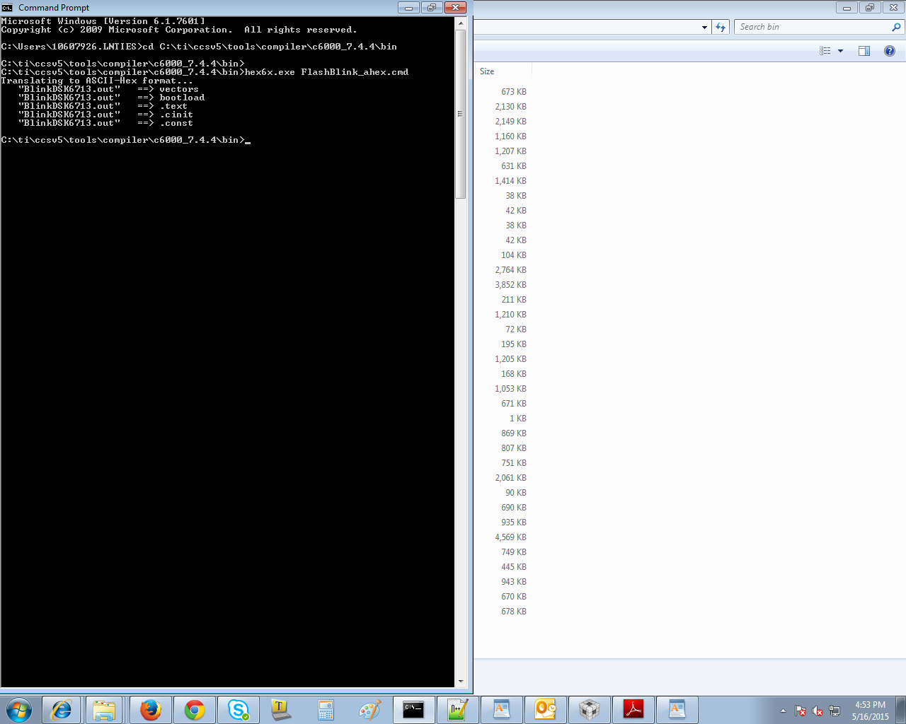

I am reporting the issue. I have been trying to convert the basic LED BLINK code to HEX format. the code was given by TI. I get the following error while converting the LED.out to hex format using HEX6X. Have attached all the files which was used and also error which i see.

Hex File Conversion.cmd file
/* FlashBlink_hex.cmd -- Hex Converter
* for FlashBlink Demo
/* To use this, from a DOS window.
To build a hex file, build the
FlashBlink application using CCS
* FlashBlink.mak file. After that,
* open a DOS window in the same dir.
* and type
* >hex6x FlashBlink_ahex.cmd
* to produce .hex for downloading.
* Use the FlashBurn application to download.
D:\DSK6713\DSK6713\DSK6713\examples\dsk6713\bsl\led\Debug\led.out
-a
-memwidth 8
-image
ROMS
FLASH: org = 90000000h, len = 0x3000,romwidth = 8, files = {BlinkDSK6713.hex}

ERROR
C:\>MyProjects\led\hex6x C:\MyProjects\led\FlashBlink_ahex.cmd
Translating C:\MyProjects\led\Debug\led.out to ASCII-Hex format...
"C:\MyProjects\led\Debug\led.out" ==> .hwi_vec
>> WARNING: section '.hwi_vec' at 00h falls in unconfigured memory (skipped)
"C:\MyProjects\led\Debug\led.out" ==> .bios
>> WARNING: section '.bios' at 0200h falls in unconfigured memory (skipped)
"C:\MyProjects\led\Debug\led.out" ==> .text
>> WARNING: section '.text' at 01980h falls in unconfigured memory (skipped)
"C:\MyProjects\led\Debug\led.out" ==> .rtdx_text
>> WARNING: section '.rtdx_text' at 02f20h falls in unconfigured memory
(skipped)
"C:\MyProjects\led\Debug\led.out" ==> .cinit
>> WARNING: section '.cinit' at 03be0h falls in unconfigured memory (skipped)
"C:\MyProjects\led\Debug\led.out" ==> .stack
>> WARNING: section '.stack' at 049b0h falls in unconfigured memory (skipped)
"C:\MyProjects\led\Debug\led.out" ==> .sysinit
>> WARNING: section '.sysinit' at 04dc0h falls in unconfigured memory (skipped
"C:\MyProjects\led\Debug\led.out" ==> .trace
>> WARNING: section '.trace' at 0534ch falls in unconfigured memory (skipped)
"C:\MyProjects\led\Debug\led.out" ==> .const
>> WARNING: section '.const' at 0554ch falls in unconfigured memory (skipped)
"C:\MyProjects\led\Debug\led.out" ==> .LOG_system$buf
>> WARNING: section '.LOG_system$buf' at 05600h falls in unconfigured memory
(skipped)
"C:\MyProjects\led\Debug\led.out" ==> .switch
>> WARNING: section '.switch' at 05aach falls in unconfigured memory (skipped)
"C:\MyProjects\led\Debug\led.out" ==> .gblinit
>> WARNING: section '.gblinit' at 05ad4h falls in unconfigured memory (skipped
"C:\MyProjects\led\Debug\led.out" ==> .log
>> WARNING: section '.log' at 05af0h falls in unconfigured memory (skipped)
"C:\MyProjects\led\Debug\led.out" ==> .sts
>> WARNING: section '.sts' at 05b08h falls in unconfigured memory (skipped)
"C:\MyProjects\led\Debug\led.out" ==> .trcdata
>> WARNING: section '.trcdata' at 05b28h falls in unconfigured memory (skipped
"C:\MyProjects\led\Debug\led.out" ==> .pinit
>> WARNING: section '.pinit' at 05b34h falls in unconfigured memory (skipped)
"C:\MyProjects\led\Debug\led.out" ==> .args
>> WARNING: section '.args' at 05b48h falls in unconfigured memory (skipped)
