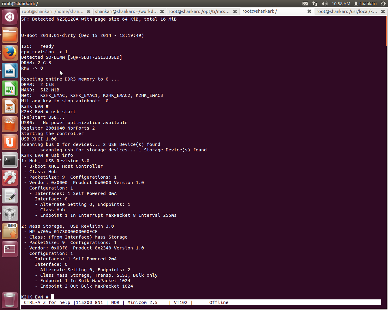

evm66ak2h most often fails to detect USB on boot
Most times I power up my evm66ak2h (which has latest uboot - version 2013.01 Apr 24 2014) it does not either: detect an inserted USB stick, or b: does not detect a USB stick inserted after boot.   Occasionally, though, it will detect the USB stick.
I have tried this with different USB sticks, waited for long periods before powering up, the connector appears to be OK, how it is inserted does not appear to affect the outcome, etc but cannot see anything consistent.
I have attached: a) the boot log (dmesg | grep usb) for a boot detecting the USB stick, and b) boot log where it doesn't detect the USB stick.
I note in the logs below that the successful boot's initial USB statements are:
[ 1.696211] usb usb1: adding 1-0:1.0 (config #1, interface 0)
[ 1.696314] hub 1-0:1.0: usb_probe_interface
[ 1.696322] hub 1-0:1.0: usb_probe_interface - got id
[ 1.716058] usb usb2: skipped 1 descriptor after endpoint
[ 1.716069] usb usb2: default language 0x0409
While the unsuccessful boot starts with:
[ 1.436338] keystone-dwc3 2690000.dwc: usbss revision 47914b00
[ 1.668352] usb usb1: default language 0x0409
Can anyone tell me what is going wrong?

    At what stage have you connected the USB pendrive ?
    Are you connecting the USB device while bootup or after booted ?
    Attach the complete bootup log of both working and non-working.
    What is your EVM revision ?
    I've seen some revision boards, USB fails occasionally.
    Please refer to the release notes (known issues) of your MCSDK release.
  • Titus,
    EVM is Rev 3.   U-BOOT is from MCSDK 3.01.03
    USB pendrive is attached while booting.
    Attached are complete boot logs for: 1. pendrive found, and 2. pendrive not found
    Bernard

  • Hi Bernard,
    As we do not see any issue on our end, let us confirm by using the same "make" of pendrives.
    From our end, we are using pendrives from "HP".
    1. What is the brand name of the pen drive you use for experiments?
    2. Did you attempt with any-other brands different form the one that you are using?... so that we can narrow down is it a issue with the USB compliance of the pendrive's firmware.
    3. Check the USB compliance standard of the pendrive as well.
    4. Being in u-boot prompt, make sure you have given commands like
       k2HK EVM # usb start
       k2HK EVM # usb info
    Below is the output logs When we connected the pendrive multiple times to the K2H EVM.
    I have experimented by attaching the pendrive and then booted linux and I donot see any USB detection problem. The bootlogs are attached for your reference.
    https://e2e.ti.com/cfs-file/__key/communityserver-discussions-components-files/791/bootlogs_5F00_with_5F00_usb_5F00_inserted.odt
    Shankari
