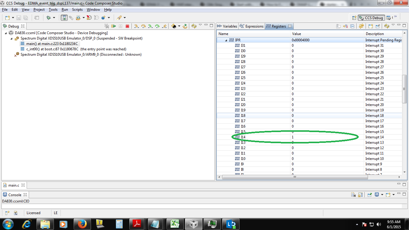

I am using TMS320C6745 and trying to use EDMA with SPI_1, but I am unable to get the IPR bit for SPI_1.
I am setting the SPI bit for DMA request enable also
spiRegs->SPIINT0 |= ( 1 << 16 ); // DMA Request Enabled
I am doing the following setting for EDMA:
static void setup_EDMA (void)
// Clear Event Registers
CSL_FINST(edma3ccRegs->ECR, EDMA3CC_ECR_REG, MASK);
CSL_FINST(edma3ccRegs->SECR, EDMA3CC_SECR_REG, MASK);
// Enable Channel 18 to DSP (Region 1)
CSL_FINST(edma3ccRegs->DRA[CSL_EDMA3_REGION_1].DRAE,
EDMA3CC_DRAE_E18, ENABLE);
// Assign Channel 18 to Queue 0
CSL_FINST(edma3ccRegs->DMAQNUM[1], EDMA3CC_DMAQNUM_E2, Q0);
// Initialize PaRAM Transfer Context for Event 18
init_PaRAM_event18();
// Enable Channel 18 Event Register
CSL_FINST(edma3ccRegs->EESR, EDMA3CC_EESR_E18, SET);
// Enable Interrupts for Channel 18
CSL_FINST(edma3ccRegs->IESR, EDMA3CC_IESR_I18, SET);
}/* setup_EDMA */
Please suggest me if any mistake I am doing while the configuration.
