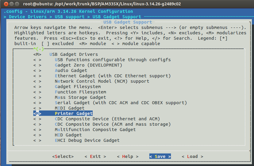

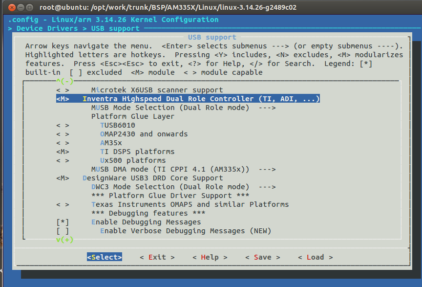

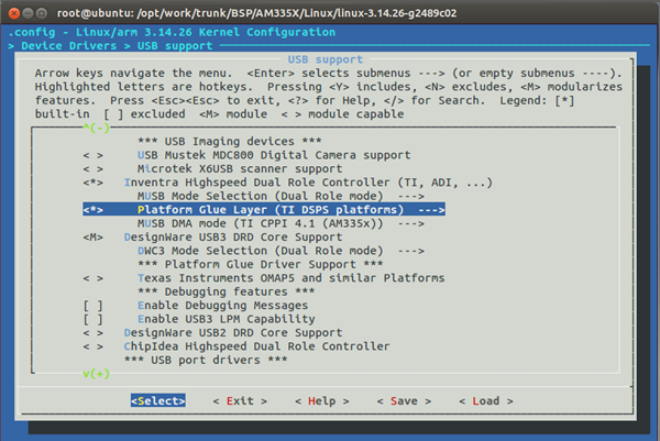

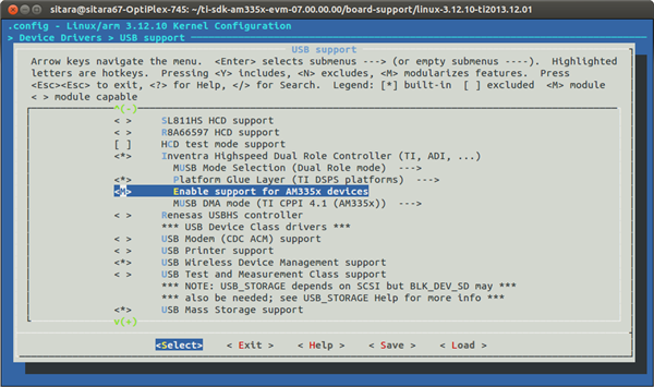

Q1. I can't fined select list in menuconfig
     there is check list (<> Enable support for AM335x device) in SDK 7
     but  there is no check list (<> Enable support for AM335x device) in SDK 8
    follow this picture below
    1) SDK7
    2) SDK8
Q2. How to use? enable? g_prineter.ko in AM335x evm board ?
      I don't know how to enable g_printer....

    1) USB support
    <M> Inventra Highspeed Dual Role Controller (TI, ADI, ...) │ │
    │ │ MUSB Mode Selection (Dual Role mode) ---> │ │
    │ │ Platform Glue Layer
    │ │ < > TUSB6010 │ │
    │ │ <M> OMAP2430 and onwards │ │
    │ │ < > AM35x │ │
    │ │ <M> TI DSPS platforms │ │
    │ │ < > Ux500 platforms │ │
    │ │ MUSB DMA mode (TI CPPI 4.1 (AM335x)) --->
    2) USB Gadget Support
    <M> Mass Storage Gadget │ │
    │ │ <M> Serial Gadget (with CDC ACM and CDC OBEX support) │ │
    │ │ <M> MIDI Gadget │ │
    │ │ <M> Printer Gadget │ │
    │ │ <M> CDC Composite Device (Ethernet and ACM) │ │
    │ │ <M> CDC Composite Device (ACM and mass storage) │ │
    │ │ <M> Multifunction Composite Gadget │ │
    How can I solve this problem?

  • ass fff said:
    step 3. kernel compile
       make -j 1 ARCH=arm CROSS_COMPILE=arm-linux-gnueabihf- zImage
       make -j 1 ARCH=arm CROSS_COMPILE=arm-linux-gnueabihf- modules
     step 4. device driver created  ok
           linux-3.14.26-g2489c02\drivers\usb\gadget\
           =>  g_printer.ko
     step 5. download kernel image into evm-board
    step 6. insmod g_printer.ko
    result :
    root@192:/lib/modules# insmod g_printer.ko
    g_printer: no symbol version for module_layout
    insmod: ERROR: could not insert module g_printer.ko: Invalid module format
    What you did up to Step 3 are correct. Then
    - Ensure in Step 5 you do 'make module_install' as Shiv pointed in the post above.
    - In Step 6, please use 'modprobe g_printer' instead. Insmod will fail because USB gadget drivers depend on USB libcomposite driver.
  • thank you for your reply
    this is my kernel compile prat in makefile
    cd /opt/work/trunk/BSP/AM335X/Linux/linux-3.14.26-g2489c02;
    make ARCH=arm CROSS_COMPILE=arm-linux-gnueabihf- singlecore-omap2plus_defconfig
    install -d /opt/work/trunk/BSP/AM335X/Linux/linux-3.14.26-g2489c02/arch/arm/boot
    install arch/arm/boot/zImage /opt/work/trunk/BSP/AM335X/Linux/linux-3.14.26-g2489c02/arch/arm/boot
    install vmlinux /opt/work/trunk/BSP/AM335X/Linux/linux-3.14.26-g2489c02/arch/arm/boot
    install System.map /opt/work/trunk/BSP/AM335X/Linux/linux-3.14.26-g2489c02/arch/arm/boot
    make ARCH=arm CROSS_COMPILE=/opt/ti-sdk-am335x-evm-08.00.00.00/linux-devkit/sysroots/i686-arago-linux/usr/bin/arm-linux-gnueabihf- INSTALL_MOD_PATH=/opt/work/trunk/BSP/AM335X/Linux/linux-3.14.26-g2489c02/arch/arm/boot modules_install
    and
    I tried to use "modprobe" commnad instead of "ismod".
    root@192:/lib/modules# ls
    3.14.26-g2489c02 bxl_zpl_printhead.ko
    bxl_adc_linux.ko configfs.ko
    root@192:/lib/modules# insmod configfs.ko
    root@192:/lib/modules# [ 344.127744] [HOTPLUG ] unknown SUBSYSTEM: module, , add
    root@192:/lib/modules# insmod libcomposite.ko
    root@192:/lib/modules# [ 370.813016] [HOTPLUG ] unknown SUBSYSTEM: module, , add
    root@192:/lib/modules# modprobe g_printer.ko
    root@192:/# lsmod
    Module Size Used by
    libcomposite 44920 0
    configfs 22302 2 libcomposite
    bxl_zpl_printhead 1415 0
    Error did not occur but I can't find g_printer driver in /dev/?
    where is g_printer driver?
    /opt/work/trunk/BSP/AM335X/RootFileSystem/Rootfs <= this path is NFS link folder
    where do you have to change in makefile or anywhere?
    Thanks in advance.
    I try to insert a debugging message on printer.c file
    I think this is not expected behaviour?
    root@192:/lib/modules# (Not print debugging message, No response)
    root@192:/lib/modules# modprobe -r g_printer.ko
    [ 3898.281716] g_printer:enable to create usb_gadget class (<= print debugging message)
    [ 3898.287248] g_printer:alloc_chrdev_region (<= print debugging message)
    [ 3898.319122] usb_gadget_probe_driver ffffffed
    insmod: ERROR: could not insert module g_printer.ko: No such device
    root@192:/lib/modules# [ 3898.494316] [HOTPLUG ] unknown SUBSYSTEM: module, , add
    [ 3898.513754] [HOTPLUG ] unknown SUBSYSTEM: class, , add
    [ 3898.522855] [HOTPLUG ] unknown SUBSYSTEM: class, , remove
    [ 3898.535342] [HOTPLUG ] unknown SUBSYSTEM: module, , remove
    Any suggestions?
