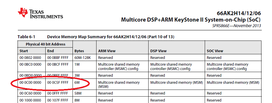

Hello all;
i am using the K2H12 Board in a project. and i would like to know if the ARM (linux) use a part of the MSMC memory by default or not?
thank you .
    Yes, MSMC RAM is used for boot monitor.
    K2HK:
    setenv bootcmd 'tftpboot 0x87000000 ${tftp_root}/uImage-k2hk-evm.dtb;tftpboot 0x88000000 ${tftp_root}/uImage-keystone-evm.bin;tftpboot 0x0c5f0000 ${tftp_root}/skern-k2hk-evm.bin;mon_install 0x0c5f0000;bootm 0x88000000 - 0x87000000'
    K2E:
    setenv bootcmd 'tftpboot 0x87000000 ${tftp_root}/uImage-k2e-evm.dtb;tftpboot 0x88000000 ${tftp_root}/uImage-keystone-evm.bin;tftpboot 0x0c140000 ${tftp_root}/skern-k2e-evm.bin;mon_install 0x0c140000;bootm 0x88000000 - 0x87000000'
  • Hi Capitaine,
    Yes, the MSMC RAM has been used for managing the cores through "boot-monitor"
    Please revert if any clarification.
    Shankari.
