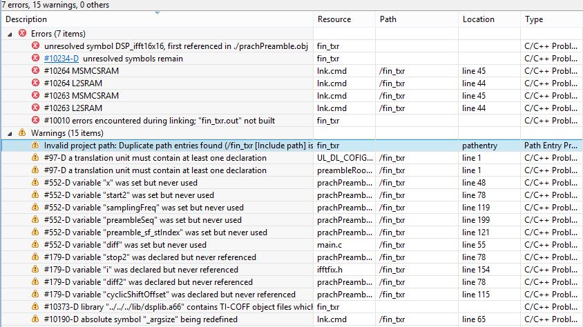

<Linking>
"C:/ti/dsplib_c66x_3_1_0_0/examples/lnk.cmd", line 44: error #10263: L2SRAM
   memory range has already been specified
"C:/ti/dsplib_c66x_3_1_0_0/examples/lnk.cmd", line 44: error #10264: L2SRAM
   memory range overlaps existing memory range L2SRAM
>> Compilation failure
"C:/ti/dsplib_c66x_3_1_0_0/examples/lnk.cmd", line 45: error #10263: MSMCSRAM
"C:/ti/dsplib_c66x_3_1_0_0/examples/lnk.cmd", line 45: error #10264: MSMCSRAM
   memory range overlaps existing memory range MSMCSRAM
warning #10373-D: library "../../../lib/dsplib.a66" contains TI-COFF object files which are incompatible with the ELF output file.  Ensure you are using the proper library.
"C:/ti/dsplib_c66x_3_1_0_0/examples/lnk.cmd", line 65: warning #10190-D: absolute symbol "_argsize" being redefined
 undefined     first referenced
  symbol           in file
 DSP_ifft16x16 ./prachPreamble.obj
error #10234-D: unresolved symbols remain
error #10010: errors encountered during linking; "fin_txr.out" not built
gmake: *** [fin_txr.out] Error 1
gmake: Target `all' not remade because of errors.
**** Build Finished ****

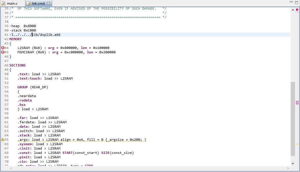

And am also attaching the corresponding  linker file and the problems that i had encountered while building the project.

  • The invocation of the linker uses two different linker command files.  Inspect the command carefully.  You can see ...
    -l"./configPkg/linker.cmd"
    and ...
    One of them needs to be removed.  Probably the second one, though I'm not certain of that.
    Thanks and regards,
    -George
  • Thank you for your precious acknowledgement. But if i remove lnk.cmd file, some errors are persisting. Am here by attaching the corresponding build log and the errors encountered while building.

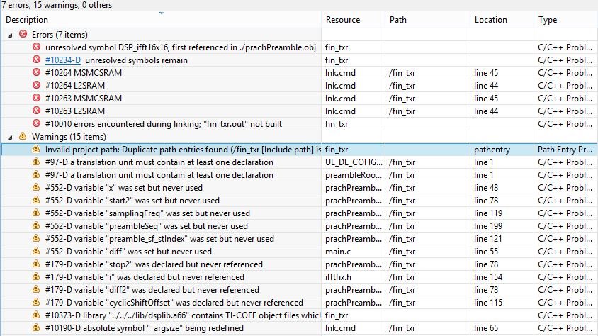

    ERRORS:
    Description Resource Path Location Type
    #10010 errors encountered during linking; "fin_txr.out" not built fin_txr C/C++ Problem
    unresolved symbol DSP_ifft16x16, first referenced in ./prachPreamble.obj fin_txr C/C++ Problem
  • The ultimate reason is here:
    Because your output binary seems to be ELF, you should refer dsplib.ae66 for linking, not dsplib.a66. Thus, DSP_ifft16x16 could not be found in object files. And, of course, merge one linker command file to use.
