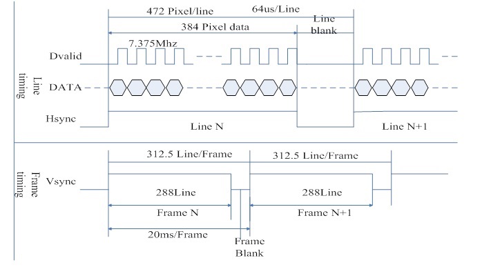

 We are trying to connect digital thermal camera to our own DM365 board using video_loopback example.
Thermal camera has an 8 bit digital interface with external HS and VS signals. Digital timing diagram is shown in figure1.

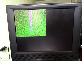

Running the video_loopback example we see a green noise image on the screen (see figure 2). We tried to change settings of the ISIF but the result is the same.
Would you explain, what is the problem, please?
If it is the ISIF settings problem, please help us to do the settings correctly.
