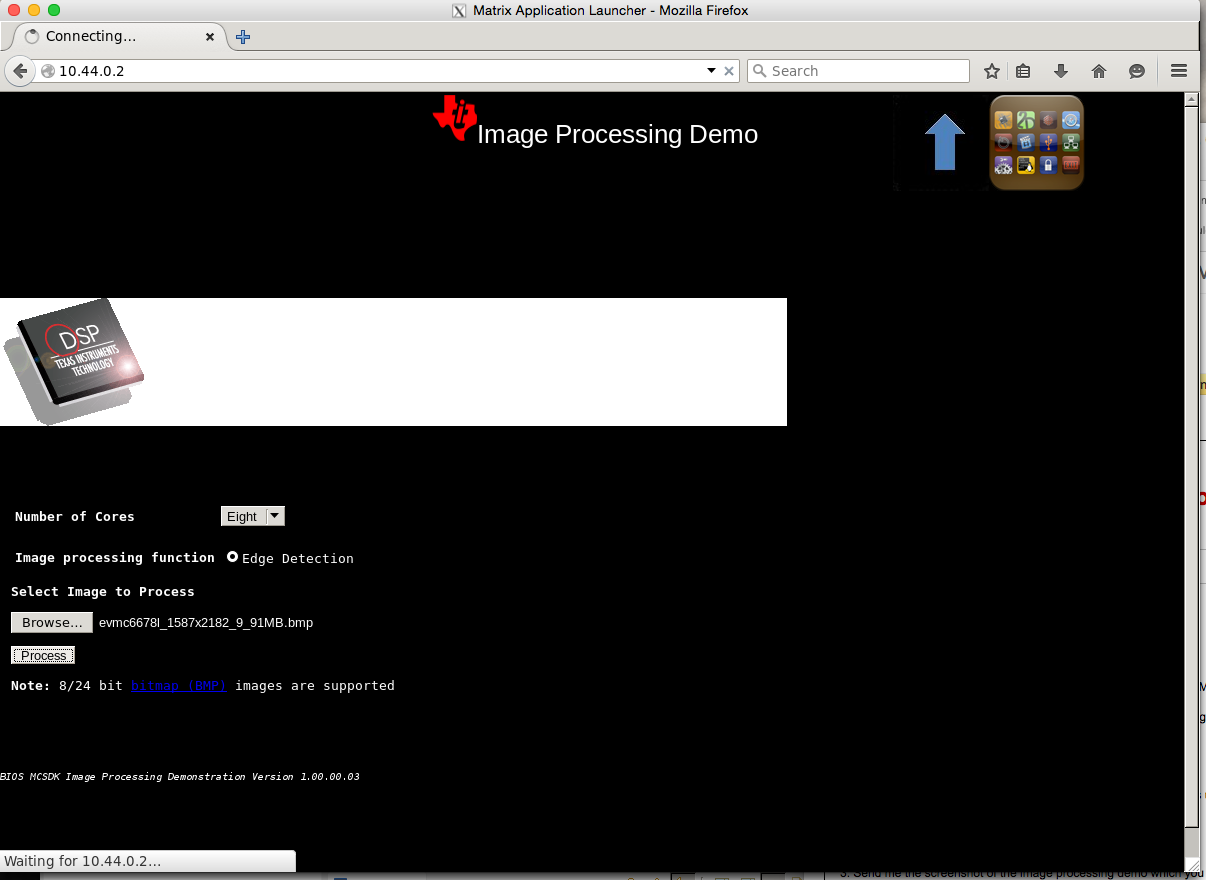

  • Hi Shankari,
    Answer to your specific questions at the bottom of the post.
    I attempted the same steps as you report above with the following results:
    First: Running the image processing demo with pre-build images FAIL
    Webpage comes up, number of cores and image is selected. After pressing "Process"
    the only thing happening in the browser (Firefox) is a note "waiting for 10.44.0.2",
    where the 10.44.0.2 corresponds to the IP address of our EVM board.
    Looking at the LAD log during the attemped run shows this:
    root@k2hk-evm:~# tail -f /tmp/LAD/lad.txt
    [0.569089]
    Initializing LAD... [0.569500]
        opening FIFO: /tmp/LAD/LADCMDS
    [74.571767] Retrieving command...
    [74.572181]

  • Hi Shankari,
    1. Not quite sure about your first question - I am able to reach the target using its IP address from the development machine (attaching
    screenshot of ping session). How do you define "correct filesystem"?
    2,3: Using Mozilla Firefox, screenshot attached.
    /Anders

    Steps to reproduce crash of image processing demo on EVMK2H
    Power-cycle board.
    In a console window:
    Log in to Linux on the EVM as root, then
    Start a Mozilla Firefox browser
    Connect to http server of evm board (10.44.0.2 in our case)
    Select "cancel" since no display is attached to board
    Select "Demonstrations"
    Select "Image Processing Demo"
    Select "Run"
    Select Number of Cores to "Eight"
    Select "Browse" an then select "evmc6678l_1587x2182_9_91MB.bmp" from the sample images
    provided with the demo.
    Select "Process"
    Image and result of operation is displayed
    Select "Back" in browser (I use the left arrow near top of window).
    Select "Process" to run again
    <nothing happens, wait a couple of seconds>
    Press the big blue up arrow, goes back to Image Processing Demo App startscreen
    Press "Run"
    <Sometimes changing the number of cores or re-selecting the file>
    Crash dump in console window.

    I am still able to run the image processing demo ONCE using the non-rt kernels and filesystems.
    It seems that our card is using a little different way of setting up the environment but that the end result is the same.
    Our environment and bootlog is copied in below and attached, respectively.
    Our first-run results match your provided application log (the order of some lined differed) and screenshot.
    Your screenshot indicates that the image is processed about 10 ms faster on your system, but I am not sure about
    precisely what that time includes - network traffic could be one possibility, I would expect times to be more similar
    if it is only computing time once the images are loaded.
    Questions:
    1. Is is possible for you to run the image processing demo MORE THAN ONCE without reboot?
    I have tried the pre-built versions on a EVMK2K board we have in the office, but that one also fails to run more than once (and fails with faultyfile descriptors/failed malloc for the example images of eval boards included in the installation). Got it running once using a smaller .bmp image though. I am not sure which versions of mcsdk that is used on the EVMK2K board.
    If the demo application does not survive being run more than once it is of course a waste of time trying to get that working here.
    About the bootlog file:
    I have copied the skern-keystone-evm.bin file as skern-k2hk-evm.bin in order to make it follow the new naming
    scheme and make it easier to switch between kernel versions, so that diff in names in the bootlog is expected.
    After boot I ran the image processing demo from a browser (times about 50 to 51) successfully.
    The i tried to run it again, first by just going back from result page and pressing "Process" - nothing happened.
    Went back to start page of image processing demo (by pressing the blue up arrow, then pressing "Run" and
    selecting number of cores and image again, followed by pressing "Process").
    This resulted in entires at times 171 to 184.
    After this I left the board alone doing some work on my development machine.
    At time 367 the board crashed without any user input.
    Regards /Anders

  • Hi Anders,
    yes with the filesystem ( mentioned in my previuos post, i.e., tisdk-rootfs.tar.gz ) able to run it repeatedly many times, without any issue, without reboot.
    Shankari.
    Please click the Verify Answer button on this post if it answers your question.
