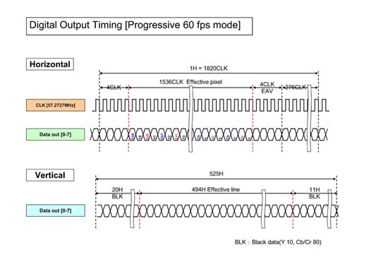

what ISIF and IPIPEIF register do I have to set when using a camera in 8bit BT656 mode?
I know the REC656IF register in ISIF, and also the 8bit per pixel pack mode etc. But I am not sure about HD/VD/FLD polarities in both ISIF and IPIPEIF. I also can't find out if I should set the internal HD/VD timing generator register in ISIF (PPLN, LPFR and MODSET.HDVDD).
I am also attaching the BT656 timing of my camera to this post.
I would appreciate some more information regarding BT656 input and/or an example register setting.
Thank you.
Sebastian

  • Hi Sebastian,
    As you rightly pointed out, REC656IF is the register that needs to be set. For HD/VD/FLD, you should keep it as input. Also PPLN, LPFR etc are not needed to be set. Anyways, it will be calculated based on embedded sync inside ISIF.
    Please refer to the section "ITU-R BT.656/ 1120 4:2:2 Parallel Interface" in VPFE user guide for more details.
    What exactly is the problem you are facing with these settings?
    Anshuman

    thank you for the reply. I read the user guide carefully again, but I could't find a fault in my settings. My program is actually a modified version of the function "static int ccdc_config_ycbcr(int mode)" from the file "dm365_ccdc.c".
    To be sure that the transmitter is working, I connected a TVP5146 chip to the VPFE. The data is transfered and displayed correctly in YCbCr 8bit mode with external syncs, but switching to BT656 results in no data inside my framebuffer.
    So I know that data gets through (from extarnal sync mode) but on the other hand, BT656 mode is just not working at all.
    My guess was that the DM365 is not handling SAV and EAV timings correctly due to a fault register setting. I noticed that in the function "static int ccdc_config_ycbcr(int mode)" the VD polarity is switched to negative when in BT656 mode, but there is no comment to that in the VPFE user guide.
    Thus the guy who wrote the LSP knew something I don't. What about you Anshuman, what do you know about the sync signals generated by the BT656 decoder?
    Sebastian

  • Hi Anshuman,
    thanks you for your register settings. I cross checked them with mine and everything with my settings seems to be ok. I noticed that you have enabled CCDCFG.VDLC and CCDCFG.Y8POS. I tried that too, but got no result.
    Just to be sure I understand the register right:
    (1) Your LNH register is 0x5af, which sets your valid pixel-clock-count to 1455+1, which means in YCC8 mode 728 horizontal 16bit pixel per line.
    (2) The LNV register is 0x833, which sets a vertical resolution of 2099+1 lines per frame.
    Is it right that your camera or at least your output window has a resolution of 728x2100 pixel?
    (3) You haven't activated CCDCFG.YCINSWP, which means that you have connected your data lines to CIN[7..0].
    My other register settings are the same as yours (except CADU/L). Maybe we can find a difference in the IPIPE/IF settings. I would appreciate if you post these too.
    Well, back to my module. It only has one framebuffer which both VPFE and VPBE are accessing. A lot of tearing but no interrupt handling for now. And as I already mentioned, everything works fine with external syncs.
    What I find very confusing is that ISIF isn't putting a single byte to the designated framebuffer. Shouldn't ISIF start writing as soon as the first embedded sync has reached the BT656 decoder?
    I am looking forward to hear from you again,
    Sebastian

  • YCINSWP is NEEDED when 8 bit data is connected to YIN lines.
    > Why do you say that YCINSWP is needed? I have connected my 8 bit data to YIN lines and the description of YCINSWP justifies my register setting and hardware connections.
    Confirmed with the owner of the IP that YCINSWP is indeed NEEDED to be set to 1, when 8 bit YUV data is connected to YIN lines. Sorry for the confusion caused earlier.
    Anshuman
