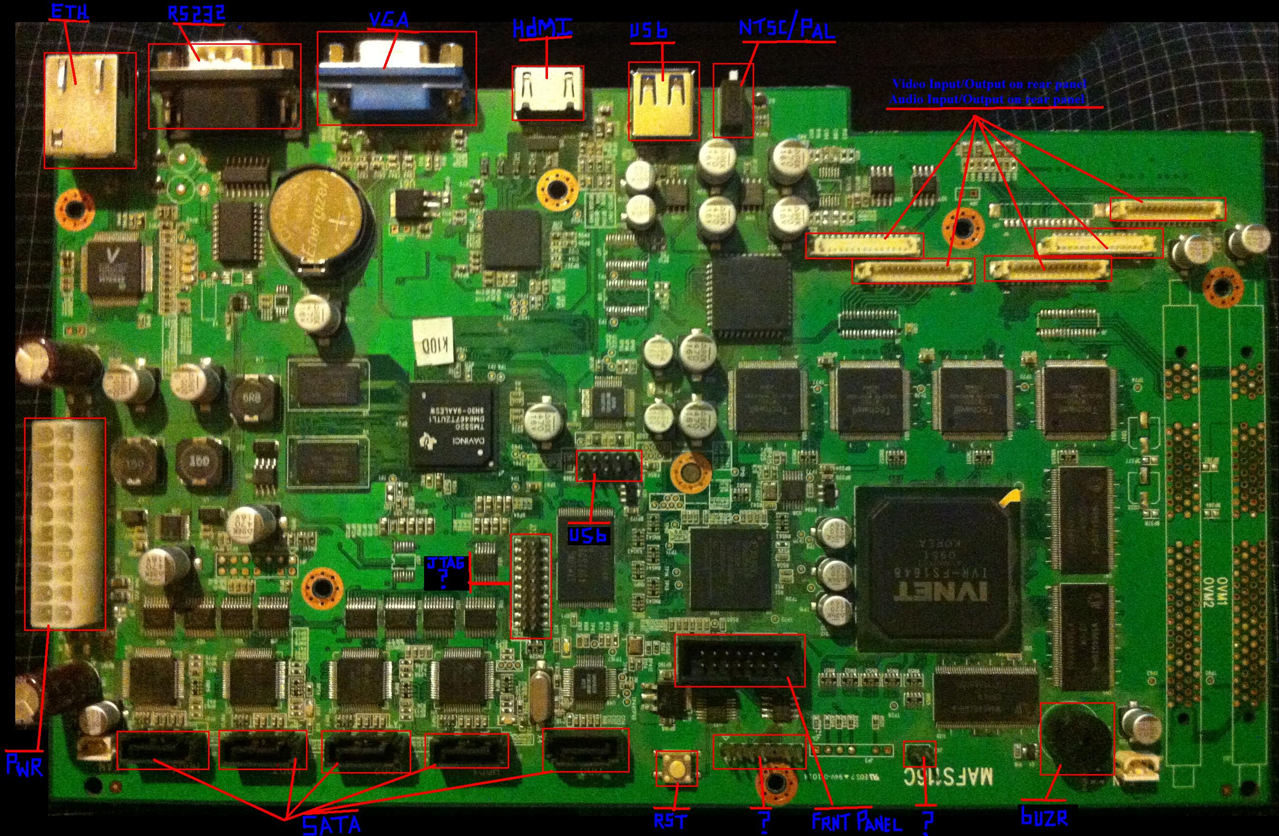

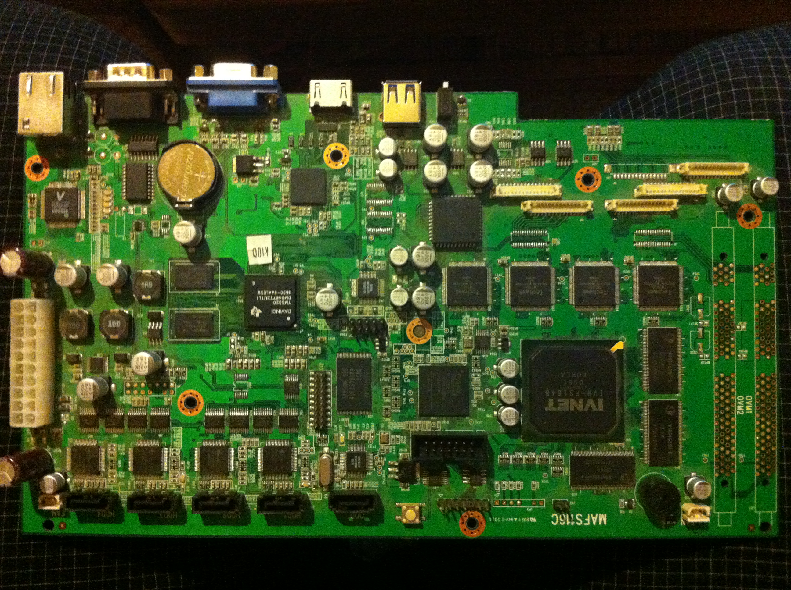

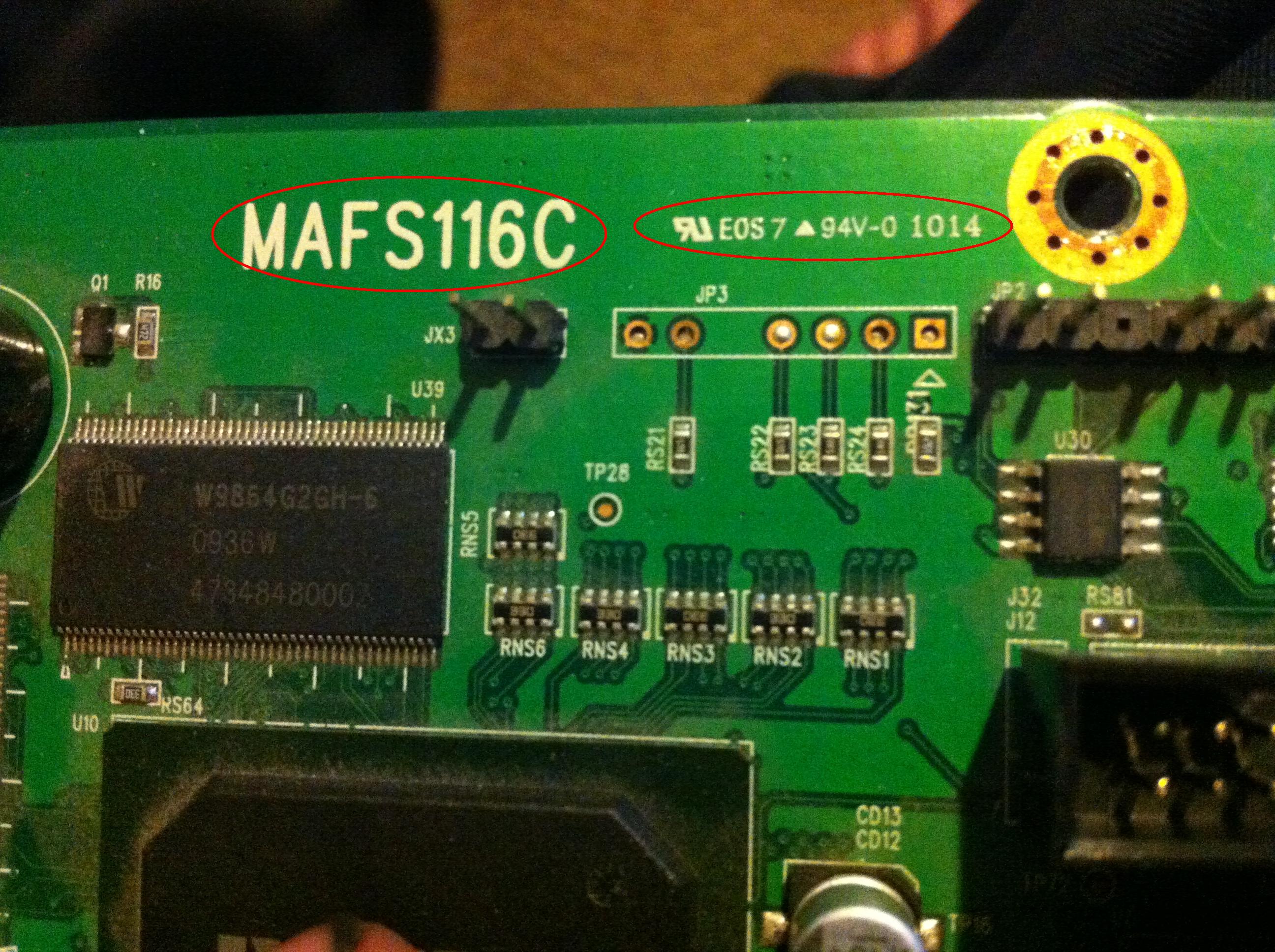

  HI, i really screwed up and i need some help.  I have a cctv standalone dvr unit ( ITXs  ANF1648)  that will no longer boot. I accidently loaded the wrong uimage .bin file using the loadb command from inside the uboot environment. the unit WILL power on, the lights on the front panel will flash on then stay off and there is no output via the serial console. ive tried factory reset but its not responding to commands via console, front panel or remote control. im guessing that the only way to recover from this is via the JTAG interface. if im wrong pls correct me.
