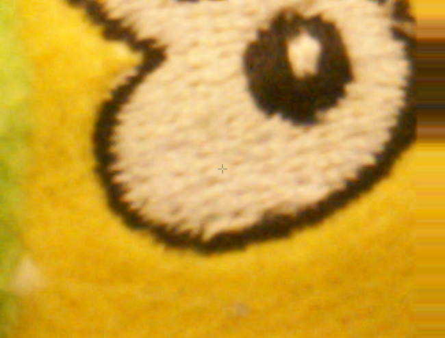

    I'm still having a problem with the Frame division mode-V, the vertical seam looks ok, but the right-hand side strip's right edge of the image is smeared/blurred as per the image below. Any ideas as what could be wrong or could be causing it would be appreciated.
    Source image: 2368x1776
    Target image: 2560x1944
    h = 2368; h1 = h2 = 1184
    H = 2560; H1 = H2 = 1280
    overlap = 20
    d = 2368/2560 * 256 = 236
    x0 = 2368 - (1184 + 20) = 1164
    X0 = 2 * ceil(((x0 * 256)/d)/2) = 1264
    x1 = 1164
    Left side:
    I_HST = 0
    O_HST = 0
    O_HSZ = 1284
    H_PHS = 0
    Right side:
    I_HSZ = 1204
    I_HST = 0
    O_HST = 16
    O_HSZ = 1280
    H_PHS = 320
    Advance input buffer pointer by 1164
    Advance output buffer pointer by 1280
    The smeared/blurred strip for above example is approximately 16 pixels but I have no idea what causes it. I suspect it has something to do with the overlap size or filter.
    Image:
    Willem
