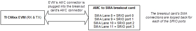

  • Hi Ganapathi,
    Thank you for your inputs, I started on the Tput benchmarking example projects and ran into a problem.
    1. I did the Internal loopback test - C-I-C and this test worked.
    2. Using a break-out card CI2EVM_Boc, I then connected my single C6678LE EVM to the BoC and tried the - "C-E-C" test. I tweaked the "benchmarking.h" file to enable the following as I am only interested in doing Type-11 at 3.125G and port width set to 4 -1x:
    #define SRIO_LANE_SPEED                   srio_lane_rate_3p125Gbps
    #define SRIO_PORT_WIDTH                   srio_lanes_form_four_1x_ports
    #define TESTS_TO_RUN                      srio_type11_tests
    #define USE_LOOPBACK_MODE                 FALSE
    This test however failed for me, I am using the pdk_C6678_1_1_2_5 and from the logs I see "[C66xx_1] Error: Transmit is unable to send packets. Packet count: 32". Looking up through the logs, I also see that the

    [C66xx_0] Throughput: (RX side, Type-11, 3.125GBaud, 1X, tab delimited)
    [C66xx_1] Debug:   SRIO status: 0x01000000.
    [C66xx_1] Debug:     Packet Response Time-out
    [C66xx_1] Debug:   Port response timeout: 0xff0fff

    . I am attaching the complete logs of the test as it fails.
    Note, I also tried one of the suggestions made on the forum and that did not help either: .
    Could you please let me know what I am missing, I see some jumper setting on the BoC card and I have left them at factory defaults.
    Niks

    Based on your above test log, the SRIO port are not connected properly. Have you referred the SRIO Benchmarking document (SRIO_Benchmarking_Example_Code_Guide)?
    SMA connections are looped back for each of the SRIO ports on the breakout card. If external line loopback is enabled, data received on RX “line” will be directly send back to TX “line”. Refer section 2.6.3 External line loopback on SRIO Programming and Performance Data document. 6825.SRIO_Programming_Performance.pdf
    Can you please elaborate when you say - "the SRIO port are not connected properly" ? Is it some change needed outside the Tput application code? The section 9.2 in "SRIO_Benchmarking_Example_Code_Guide.doc" says :
    • This mode is for core to core transfers on the same EVM using external loopback. In this mode only one version of the .out file is needed. The .out file will be run on core 0 (the consumer) and core 1 (the producer). It is assumed that the board is properly looped back over the external interface via a SMA break-out board.
    Can you explain what the above statement in bold mean?
    Niks
    If external line loopback mode, all SRIO ports RX “line” will be directly connected back to TX “line”.
