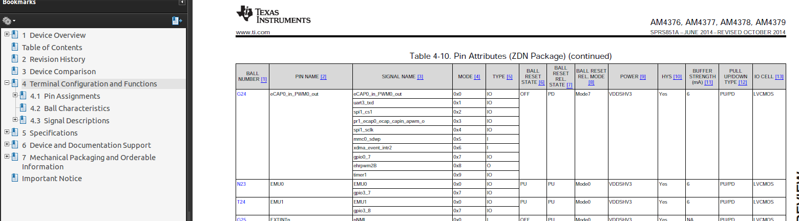

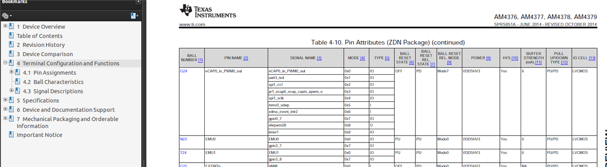

I'm using an AM4378.  If I wanted to use ball N23 or T24 as a gpio, will the PU ever be temporarily disabled as it switches from the ball reset rel. mode to Mode7 or will the ball be outputting a high voltage from the very beginning of the boot process till after it changes from Mode0 to Mode7?  I'm asking this because I have a particular signal for one of my components that needs to stay high at all times during bootup and can only drop voltage after a certain amount of time, so if the PU ever gets disabled that would be bad.
