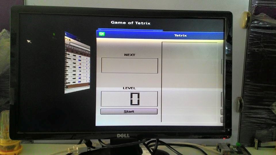

I am using Openboard-phyCORE-AM335x board and PCM-051 SOM for our project development.
We have designed a new PCB for THS8135 based on THS8135 EVM .
We interfaced with the TI-AM3359 ( Phytec phyCORE-AM335x).
We have added the support in Board file and timing parameters in Driver.
In Board file :
 .manu_name = "vga_vesa",
 .controller_data = &lcd_cfg,
 .type = "VGA_Monitor",
In drivers/video/da8xx-fb.c
[10] = {
 .name = "VGA_Monitor",
 .width = 640,
 .height = 480,
 .hfp = 16,
 .hbp = 81,
 .hsw = 63,
 .vfp = 10,
 .vbp = 33,
 .vsw = 3,
 .pxl_clk = 25000000,
 .invert_pxl_clk = 0,
While booting kernel the display parameters got detected and we are getting the resolution values(640x480@60HZ) on Monitor.
            [    0.227722] da8xx_lcdc da8xx_lcdc.0: GLCD: Found VGA_Monitor panel
            [    0.245910] Console: switching to colour frame buffer device 80x30

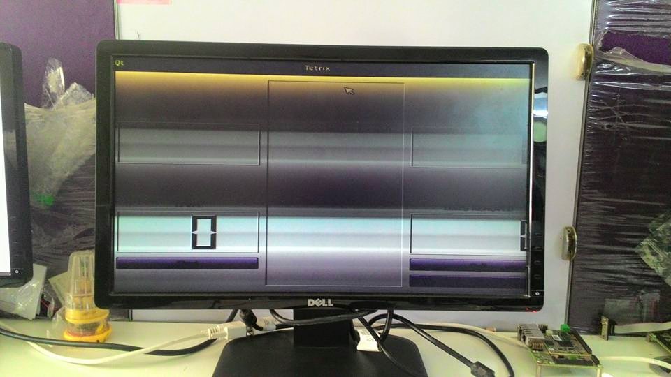

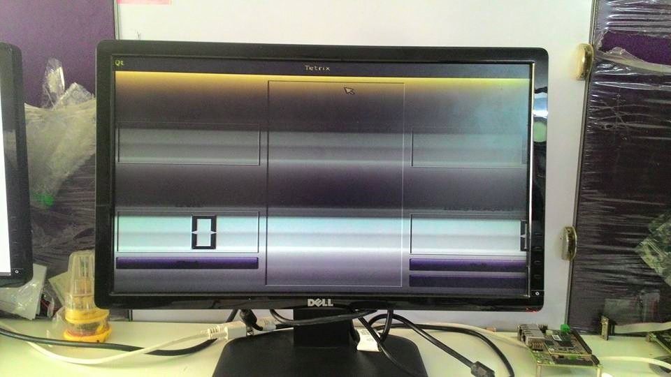

Now "VGA" is working fine.but once maximize the image or scroll the image right side corner of monitor,it suddenly change to black color.
For your Ref :  LCD is Working good on same board.
Please Help me to resolve this.
For your quick reference attaching few screenshots with the above issues clearly visible.
